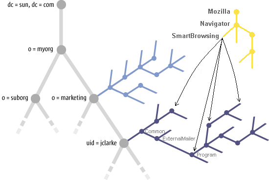

The Desktop Manager deals with four different hierarchical structures, also known as trees. To understand how the Desktop Manager works, it is important to distinguish these trees.
The first tree is the organization tree, the gray area inFigure 5–1, which represents the relationships between organizational units. The first level of the tree represents the organization itself. Subsequent levels can represent, for instance, departments and sub-departments. The last level can represent the members of these departments.
The second tree is the domain tree, which represents relationships between elements of the network such as domains or hosts. The first level of the tree represents the overall network. Subsequent levels can represent, for instance, the various subnets, and the last level the actual hosts in these subnets.
In the Desktop Manager, these two trees are currently obtained by interpreting the contents of an LDAP server, which is the typical repository for corporate structures. Each location within the tree in LDAP is called an element. Entries in a LDAP server are mapped to the elements recognized by the Desktop Manager, namely "Organization", "Role", "User", "Domain" and "Host".
The third tree is the configuration tree, which are represented by the blue areas in Figure 5–1. The configuration tree hierarchically groups configuration settings in the back end. At the highest level of the configuration tree are components. Components comprise configuration settings that configure one software component. All elements below a component are either nodes or properties. Nodes can contain nodes or properties. Properties contain configuration settings. Each configuration setting can be referred to by a path. For example, org.openoffice.Office.Common/ExternalMailer/Program is referring to the "Program" configuration setting, which is in the "External Mailer" node under the "Common" component.
Each element in the organization or domain tree can have its own configuration tree, resulting in two "trees of trees", one being an organization tree containing configuration trees and the other a domain tree containing configuration trees.
The fourth tree is the configuration profiles tree, which is represented by the yellow area of Figure 5–1. The configuration profiles tree is used to visually organize the configuration settings in order to conveniently browse and edit them. This is done by defining a hierarchy that is completely independent from the hierarchy in the configuration tree. The concrete values that are displayed in the configuration profile tree are obtained by referencing the location of the configuration settings in the configuration tree. See the arrows in Figure 5–1. This allows for the separation of the different design requirements for GUI and back-end data. For example, the position of a configuration setting changes more rapidly on the GUI than in the back end.

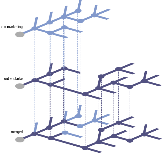

The configuration settings that are finally used for a given element is determined by merging the configuration settings of that element and those of its parent elements on the client side. For instance, the settings for a user take into account the profiles assigned to that user and those assigned to the organizations that the user belongs to. The merging works by inheritance, that is, the user inherits the settings specified in the upper levels of the organization structure. This process is illustrated in Figure 5–2, which shows how the settings of the "marketing" organization are inherited by one of its members, user "jclarke". The configuration settings of user "jclarke" override some of the inherited settings.
The three strata are merged to form the final set of configuration settings in the same way that the configuration settings are merged in the profile stratum. The user stratum takes precedence over the profile stratum, which in turn takes precedence over the default stratum. It is possible to mark configuration settings in the profile stratum so that configuration settings in the user stratum are no longer considered during the merge process, so that users not allowed to override settings made by an administrator with the Desktop Manager on their own client machines. This is called protection.
