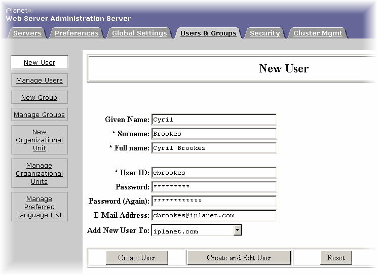

Now create yourself as a user in the Web Server Administration, under the 'Users & Groups' tab.

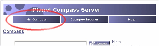

Let's test your My Compass installation. Go to the my compass server, there should now be a "My Compass" button in the upper right hand corner. When you click it, you should be prompted for the userid and password you just created.

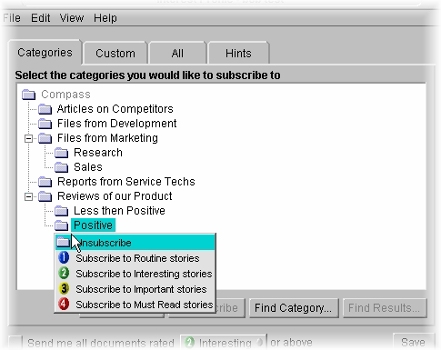

The next page will launch your interest profile editor. This will give you the opportunity to add several categories to track in My Compass. Select categories by clicking on the folders and selecting the minimum rating you wish a document to have to receive it in your My Compass newsletter.
You may also check the box at the bottom to receive documents systemwide that receive a high rating.
Select as many categories as you like, save it, and then click the "Finish" button.

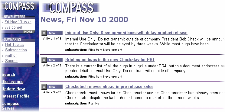

Now to send yourself your first newsletter. Go back to the Compass Admin and go to the My Compass tab. Then click the "Activate Profiler Button"

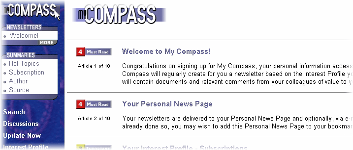

Then go back to your My Compass screen and refresh it and you should have your first newsletter.
Also, if you selected to have the newsletters mailed to you, you should receive a copy in your mail program.

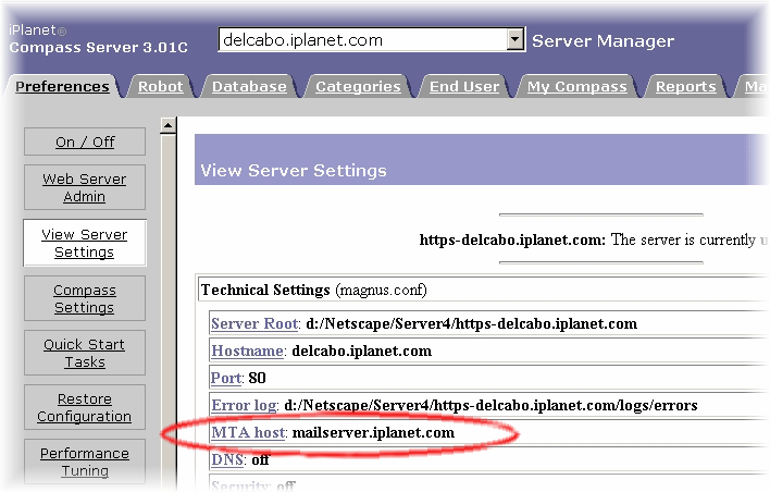

If you are having trouble getting your mail, be sure you have a mailing agent selected in your Compass Settings:

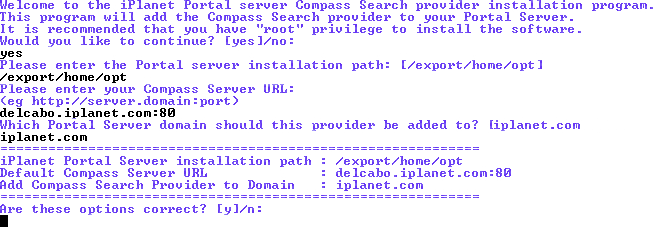

INSTALLING THE PORTAL PROVIDER
Installing the portal provider for Personalized Knowledge Services is the same as it is for the Compass product. The install program is located at:
/netscape/server4/plugins/compass/samples/portal_pks/
Switch to that directory and run 'install'.
  • You'll need to be logged into root or equivalent when you install
  • The 'portal server installation path' default is correct if you used the defaults when you installed portal

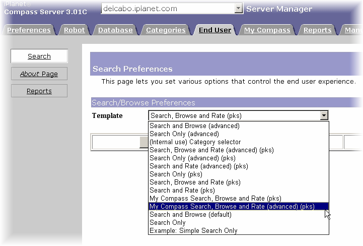

Personalized Knowledge Services ships with several new Compass Templates designed to organize your information around the My Compass ratings. You can modify the default template from the End User tab in Compass Admin.
NOTE: This affects the search function for all Compass users. It does not control the template used for Search in My Compass.

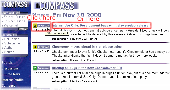

There are several ways to rate a document. If you are in your My Compass newsletter (either mailed to you or on the My Compass web page) or the My Compass Search, you may click either the 'Rating' icon or the 'Title' link:

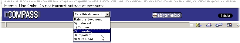

And you will get the web page with the rating bar. To rate a page, simply select your rating from the pull down:
NOTE: From a My Compass enabled Compass template, you will only get the rating bar if you click on the 'Rating' icon, not on the 'Title' link.

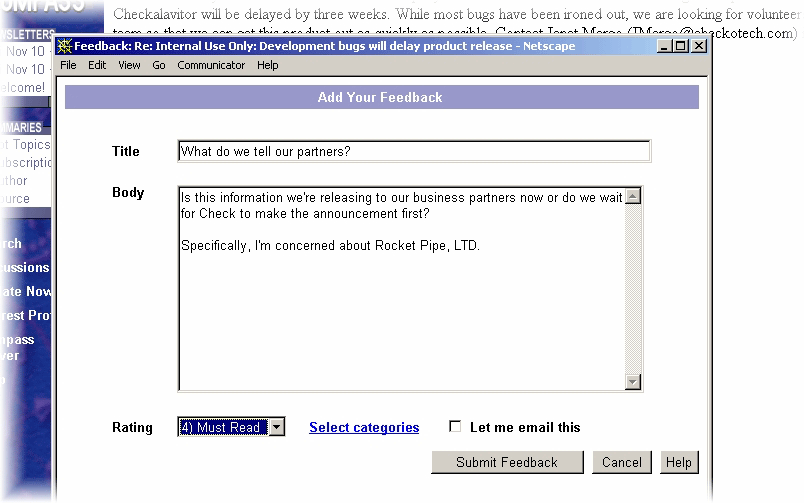

You can also add feedback to from the rating bar:
When you click on the button, it will launch a window with a place to enter a comment. When you're done, You just click "Submit Feedback". You can also do rating and a variety of other functions from this window. Look in the My Compass Users Guide for complete details.

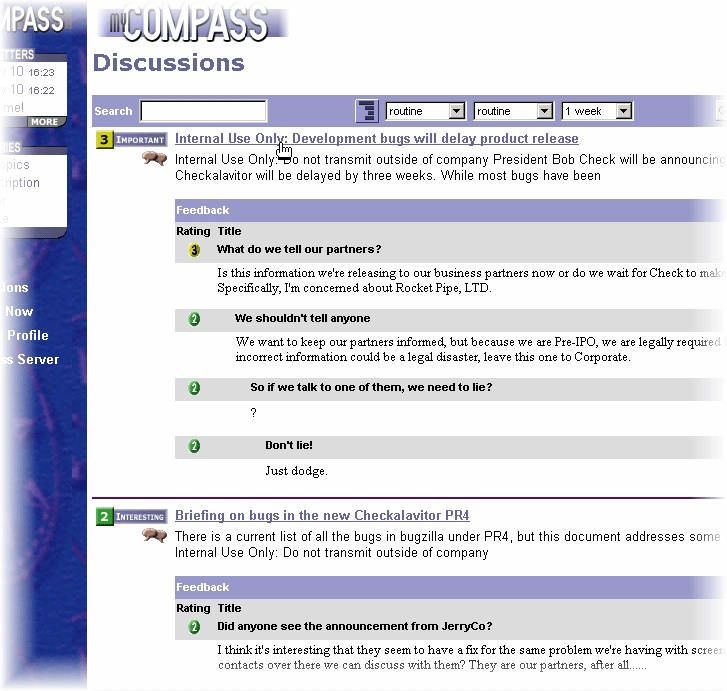

My Compass Discussions
Lastly, you should take a look at the new My Compass Discussions. This tool is a powerful way for people to add and talk about existing documents or create their own. Look in the My Compass Users Guide for complete details.
