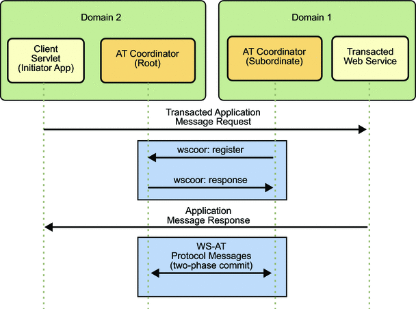

With the SampleServiceClient client, the WS-Coordination/WS-AtomicTransaction protocol messages flow back and forth between the two GlassFish instances just as they do in the Microsoft-to-Sun transaction interoperability scenario with the msclient client.
The basicWSTX example was initially designed so it could be run in either one or in two GlassFish domains. If you run the example in one domain, only one coordinator is used; no WS-Coordination protocol messages will be exchanged. This chapter explains how to run the example in two domains so both protocols, WS-Coordination and WS-AtomicTransaction (WS-AT), are used, as shown in Figure 12–1.
The example also provides the msclient client, which is the equivalent of the client servlet shown in Domain 2.

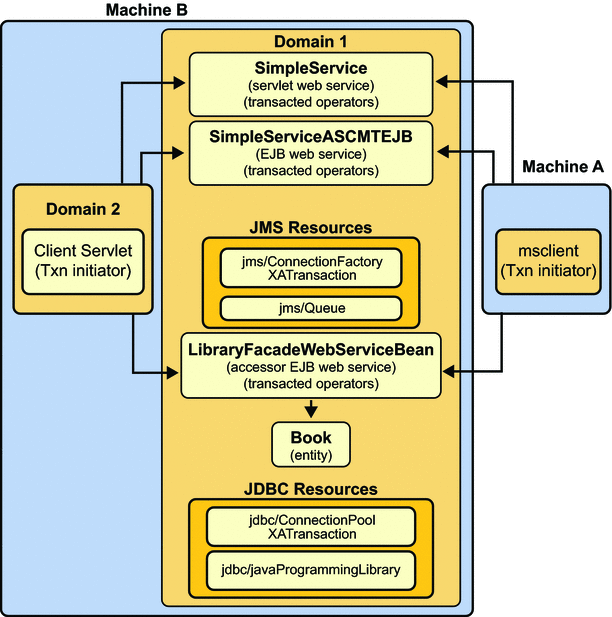

Figure 12–2 shows the components that make up the two domain example. Again, the msclient client would be equivalent to the client servlet in Domain 2 in this figure as well.
The service, which runs in domain1, is comprised of two components:
SimpleService, a web service that is implemented as a servlet with transacted operations
SimpleServiceASCMTEJB, a container-managed transaction enterprise bean (CMT EJB) web service
The SimpleService web service uses two JMS resources that are created in domain1:
jms/ConnectionFactory, an XATransaction connection factory
jms/Queue, a JMS queue
The LibraryFacadeWebServiceBean web service uses the Java Persistence API (JPA) with two JDBC resources that are created in domain1:
connectionPool, an XATransaction JDBC connection pool
jdbc/javaProgrammingLibrary, a JDBC connection resource
The client servlet, which runs in domain2, initiates the transaction.

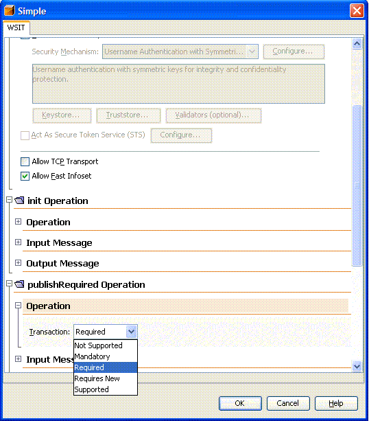

Set the proper transaction attributes for each mapping (wsdl:binding /wsdl:operation) in the SimpleService-war web service.
This operation creates file SampleService\SampleService-war\web\WEB-INF\wsit-wstx.sample.service.Simple.xml, in which the transaction attribute settings for the SampleService-war are stored.
To set the transaction attributes for the SampleService-war web service:
In the Projects tab, open the SampleService-war project.
Open the Web Services node.
Right-click Simple and select Edit Web Service Attributes.
Select the WSIT tab and open the Operation node and then the method node in each section. Select the indicated setting for each of the following operations from the Transaction menu:
Set init to Required.
Set publishRequired to Required.
Set publishSupports to Supported.
Set verify to Required.
Set getMessage to Required.
Figure 12–3 shows how this is done for the publishRequired operation.
Click OK.

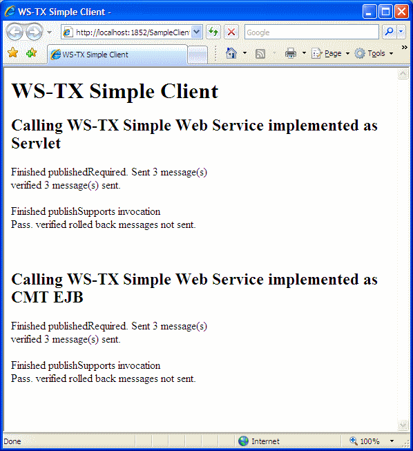

Deploy and run the client. Right-click SampleClient and select Run Project.
NetBeans IDE will start domain2, deploy the servlet and EJB CMT clients to that domain, then display the results for both in a pop-up browser window, as shown in Figure 12–4.
