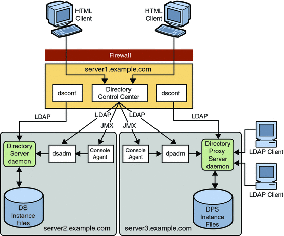

Before you read this section, read Directory Server Enterprise Edition Administration Model in Sun Java System Directory Server Enterprise Edition 6.3 Deployment Planning Guide. Consider the following figure which shows how the network traffic flows. The figure shows network traffic flows between the configuration management tools, DSCC, dsconf(1M), and dpconf(1M), the local administration agents, and servers. The figure also shows communication between the local agents, the local command line tools, dsadm(1M) and dpadm(1M), and the servers that you manage.
Notice the command line management and monitoring tools, dsconf(1M) and dpconf(1M), require only LDAP access to the servers that you manage. LDAP traffic typically flows through the default ports, 389 for LDAP and 636 for secure LDAP using SSL. When you create servers as a non-root user, the default ports are 1389 for LDAP, and 1636 for secure LDAP using SSL.

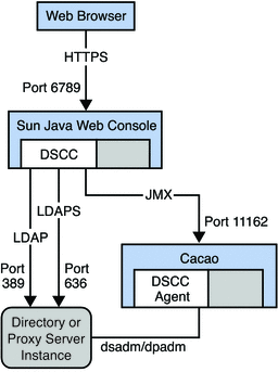

You typically install DSCC on only one system in your deployment. You then manage all your servers from that installation of DSCC. You access DSCC through a browser using the URL, https://hostname:6789, http://hostname:8080, or https://hostname:8181 based on the software distribution you use to install Directory Server Enterprise Edition and the configuration of the application server in case of installation using the zip distribution.
DSCC requires LDAP access to the servers for online management operations. DSCC also requires Java Management Extension (JMX) access to agents installed alongside the servers. The agents perform server process management operations on behalf of DSCC, that cannot be performed through LDAP on a running server. You can use DSCC to create and to start new servers.
As part of the normal installation process, you install the local DSCC agents alongside server software. DSCC contacts the agents over the network using a specific port number. You must therefore either accept the default port number, 11162, or specify a different port number.
The agents run inside a common agent container on the server system. This common agent container provides its agents with a single external port for management applications. The common agent container also consolidates resources to save resources on systems where multiple local agents share the container. The common agent container is the agent that listens for DSCC on the default port number, 11162, routing management traffic to other agents. DSCC communicates with local agents through the common agent container. For troubleshooting purposes, a common agent container can be managed independently using the cacaoadm command.
