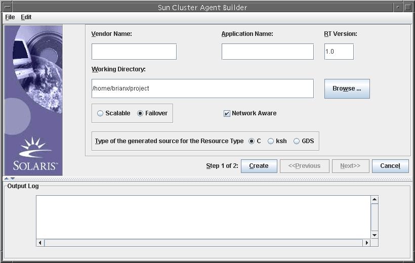

The first step in creating a resource type is to complete the Create screen, which appears when you start Agent Builder. The following figure shows the Create screen after you type information in the fields.
The Create screen contains the following fields, radio buttons, and check box:
Vendor Name. A name that identifies the vendor of the resource type. Typically, you specify the stock symbol of the vendor. However, any name that uniquely identifies the vendor is valid. Use alphanumeric characters only.
Application Name. The name of the resource type. Use alphanumeric characters only.
Together, the vendor name and application name make up the full name of the resource type. Starting with the Solaris 9 OS, the combination of Vendor Name and Application Name can exceed nine characters.
RT Version. The version of the generated resource's type. The RT Version distinguishes between multiple registered versions, or upgrades, of the same base resource type.
You cannot use the following characters in the RT Version field:
Space
Tab
Slash (/)
Backslash (\)
Asterisk (*)
Question mark (?)
Comma (,)
Semicolon (;)
Left square bracket ([)
Right square bracket (])
Working Directory. The directory under which Agent Builder creates a directory structure to contain all the files that are created for the target resource type. You can create only one resource type in any one working directory. Agent Builder initializes this field to the path of the directory from which you started Agent Builder. However, you can type a different name or use Browse to locate a different directory.
Under the working directory, Agent Builder creates a subdirectory with the resource type name. For example, if SUNW is the vendor name and ftp is the application name, Agent Builder names this subdirectory SUNWftp.
Agent Builder places all the directories and files for the target resource type under this subdirectory. See Directory Structure That Agent Builder Creates.
Scalable or Failover. Specify whether the target resource type is failover or scalable.

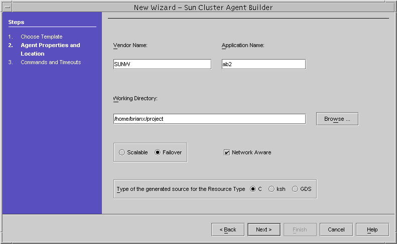

Network Aware. Specify whether the base application is network aware, that is, if it uses the network to communicate with its clients. Select the Network Aware check box to specify network aware, or do not select the check box to specify nonnetwork aware.
C, ksh. Specify the language of the generated source code. Although these options are mutually exclusive, with Agent Builder you can create a resource type with Korn shell-generated code and reuse the same information to create C generated code. See Reusing Code That You Create With Agent Builder.
GDS. Specify that this service is a generic data service. Chapter 10, Generic Data Services contains more detailed information about creating and configuring a generic data service.
If the cc compiler is not in your $PATH variable, Agent Builder grays out the C radio button and allows you to select the ksh radio button. To specify a different compiler, see the note at the end of Installing and Configuring Agent Builder.
After you have specified the required information, click Create. The Output Log area at the bottom of the screen shows the actions that Agent Builder performs. You can choose Save Output Log from the Edit menu to save the information in the output log.
When finished, Agent Builder displays either a success message or a warning message.
If Agent Builder was unable to complete this step, examine the output log for details.
If Agent Builder completes successfully, click Next to display the Configure screen. The Configure screen enables you to finish generating the resource type.
Although generation of a complete resource type is a two-step process, you can exit Agent Builder after completing the first step (create) without losing the information that you have specified or the work that Agent Builder has completed. See Reusing Code That You Create With Agent Builder.

The Cluster Agent module for Agent Builder is a NetBeansTM module. This module enables you to create resource types for the Sun Cluster software through the Sun Java Studio product.
The Sun Java Studio documentation contains information about how to set up, install, and use the Sun Java Studio product. You can find this documentation at the http://wwws.sun.com/software/sundev/jde/documentation/index.html web site.
The Cluster Agent module is installed when you install the Sun Cluster software. The Sun Cluster installation tool places the Cluster Agent module file scdsbuilder.jar in /usr/cluster/lib/scdsbuilder. To use the Cluster Agent module with the Sun Java Studio software, you need to create a symbolic link to this file.
The Sun Cluster and Sun Java Studio products and Java 1.4 must be installed and available to the system on which you intend to run the Cluster Agent module.
Enable all users or only yourself to use the Cluster Agent module.
To enable all users, become superuser or assume a role that provides solaris.cluster.modify RBAC authorization, and create the symbolic link in the global module directory.
# cd /opt/s1studio/ee/modules # ln -s /usr/cluster/lib/scdsbuilder/scdsbuilder.jar |
If you installed the Sun Java Studio software in a directory other than /opt/s1studio/ee, substitute this directory path with the path that you used.
To enable only yourself, create the symbolic link in your modules subdirectory.
% cd ~your-home-dir/ffjuser40ee/modules % ln -s /usr/cluster/lib/scdsbuilder/scdsbuilder.jar |
Stop and restart the Sun Java Studio software.
The following steps describe how to start the Cluster Agent module from the Sun Java Studio software.
From the Sun Java Studio File menu, choose New, or click this icon on the toolbar:
The New Wizard screen appears.
In the Select a Template pane, scroll down (if necessary) and click the key next to the Other folder.
The Other folder opens.
From the Other folder, select Sun Cluster Agent Builder and click Next.
The Cluster Agent module for Sun Java Studio starts. The first New Wizard - Sun Cluster Agent Builder screen appears.
Use the Cluster Agent module as you would the Agent Builder software. The interfaces are identical. For example, the following figures show that the Create screen in the Agent Builder software and the first New Wizard - Sun Cluster Agent Builder screen in the Cluster Agent module contain the same fields and selections.
Despite the similarities between the Cluster Agent module and Agent Builder, minor differences exist:
In the Cluster Agent module, the resource type is created and configured only after you click Finish on the second New Wizard - Sun Cluster Agent Builder screen. The resource type is not created when you click Next on the first New Wizard - Sun Cluster Agent Builder screen.
In Agent Builder, the resource type is immediately created when you click Create on the Create screen. In addition, the resource type is immediately configured when you click Configure on the Configure screen.
The information that appears in the Output Log area in Agent Builder appears in a separate window in the Sun Java Studio product.
