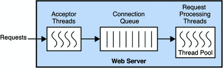

Before tuning your server, you should understand the connection-handling process in Web Server. Request processing threads handle Web Server connections. You can configure Request handling threads from the Admin Console or by editing the server.xml configuration file. This section includes the following topics:
In Web Server, acceptor threads on a listen socket accept connections and put them into a connection queue. Request processing threads in a thread pool then pick up connections from the queue and service the requests.
