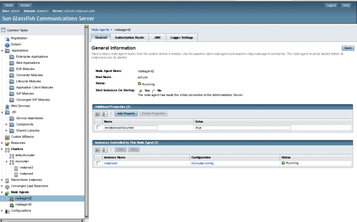

Create and start a node agent (nodeagent2) on the DAS machine.
Use the following command: asadmin create-node-agent --user admin --host schumi nodeagent2
Start the node agent on the DAS machine.
Use the following command: asadmin start-node-agent --user admin --host schumi nodeagent2. For more information, see start-node-agent(1) command.

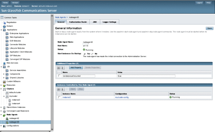

Create a start a node agent on another machine.
This example uses a second machine called sr115. On the second machine, at the invoke the asadmin utility and use the following command: asadmin create-node-agent --user admin --host schumi nodeagent3
You need to provide the DAS machine name in the --host option.
Start the node agent on the second machine.
Use the following command: asadmin start-node-agent --user admin --host schumi nodeagent3. For more information, see start-node-agent(1) command.

You can see that the two node agents are running if you click Node Agents on the left-hand tree on the Admin Console.

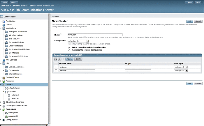

On the left pane, click the Clusters tab and click New.
Specify a name for the cluster.
This example creates a cluster with the name, mycluster.
In the Server Instances to be Created section, click New.
Type the instance name as instance3 and choose node agent, nodeagent3.
nodeagent3 was created on the machine called sr115 in step 2 of this procedure.
Type the instance name as instance4 and choose node agent, nodeagent2.
nodeagent2 was created on the DAS machine called schumi in step 1 of this procedure.
Click OK.
The cluster gets created.

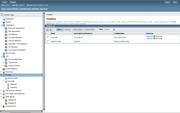

In the left pane, click Clusters.
In the right pane, select the checkbox next to mycluster and click the Start Cluster button,
The cluster and the two instances start.
The two instances in mycluster are running on different machines and are controlled by different node agents. You can view the two node agents and see each instance associated with it.
If you deploy an application on mycluster, the application is accessible from two machines.

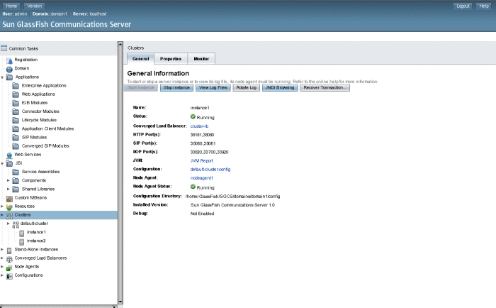

You can view the ports numbers and override the default values for the clustered server instance you created in the previous section, Setting Up a Cluster with Converged Load Balancer . By default, the HTTP ports are 38081 for instance1 and 38080 for instance2. If these ports were busy on your machine when you created these clusters, or if you had already assigned these ports to other instances and clusters, different port numbers were assigned.
To view the port numbers and optionally override the default values, follow these steps:
In the left pane, expand Clusters and click default-cluster to display the General Information page for clusters.
Click the Instances tab to display instance1 and instance2, the instances that you created.
