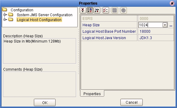

Increasing the Logical Host Heap Size
To avoid memory errors on the Logical Host, increase the heap size for the Logical Host to at least 1024 MB as described below.
ProcedureTo increase the Logical Host heap size
  1. In the Environment Explorer tab in Enterprise Designer, right-click the Logical Host, and click Properties.
    The Properties dialog box appears.
    See Figure 8–1.
  2. In the Heap Size box, enter the new heap size.
    Figure 8–1 Increasing Logical Host Heap Size
  3. Click OK.
