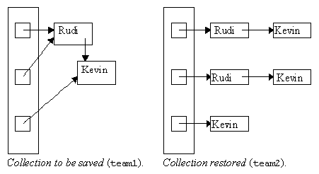

This example shows one of the shortcomings of simple persistence: its inability to maintain the pointer relationships among persisted objects. Let's say that you have a class Developer that contains a pointer to other Developer objects:
Developer {
public:
Developer(const char* name, const Developer* anAlias = 0L)
: name_(name), alias_(anAlias) {}
RWCString name_; // Name of developer.
const Developer* alias_; // Alias points to another Developer.
Now let's say that you have another class, Team, that is an array of pointers to Developers:
class Team {
public:
Developer* member_[3];
Note that Team::member_ doesn't actually contain Developers, but only pointers to Developers.
We'll assume that you've written overloaded extraction and insertion operators that use simple persistence to save and restore Developers and Teams. The example code for this is omitted to keep the explanation from getting cluttered.
When you save and restore a Team with simple persistence, what you restore may be different from what you saved. Let's look at the following code, which creates a team, then saves and restores it with simple persistence.

Because this example uses simple persistence, which does not maintain pointer relationships, the restored team has different pointer relationships than the original team. Figure 1 shows what the created and restored teams look like in memory if you run the program.
As you can see in Figure 1, when objects that refer to each other are saved and then are restored with simple persistence, the morphology among the objects can change. This is because simple persistence assumes that every pointer reference to an object in memory refers to a unique object. Thus, when such objects are saved, two references to the same memory location will cause two copies of the contents of that memory location to be saved, and later restored.
