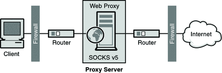

Figure 15–1 Position of a SOCKS Server in a Network
Diagram showing the position of a SOCKS server in a Network.
