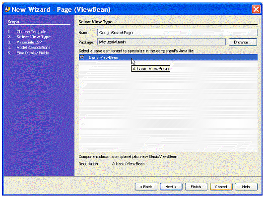

The Select View Type panel displays.
This figure shows the Select View Type panel of the New Page (ViewBean) Wizard.
3. Enter GoogleSearchPage in the Name field (to replace <default>).
4. Select Basic ViewBean.
5. Click Next.

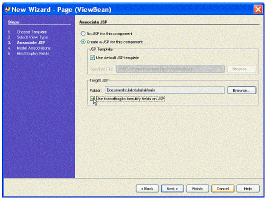

The Associate JSP panel displays.
This figure shows the Associate JSP panel of the New Page (ViewBean) Wizard.
6. Check the Use formatting to beautify fields on JSP option.
7. Click Next.

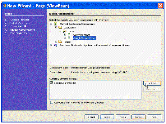

The Model Associations panel displays.
This figure shows the Model Associations panel of the New Page (ViewBean) Wizard.
8. Expand Current Application Components to expose jatotutorial -> main.
9. Select GoogleSearchModel.
10. Click Add.
11. Click Next.

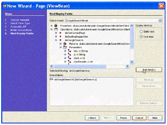

The Bind Display Fields panel displays.
This figure shows the Bind Display Fields panel of the New Page (ViewBean) Wizard.
12. Add the first field (as seen above):
a. Expand the doGoogleSearch operation node.
b. Expand the Parameters node.
c. Select the q field (q for query string: q -> String).
d. Select the Text field option.
e. Click Add field(s).
The q field is added to the Bound fields list box.
Note - You are not finished with this wizard panel yet.
13. Add the following fields as Text fields (WebService model fields are not multi selectable like JDBC model fields):
a. start
b. maxResults
c. restrict
14. Add the following fields as Static text fields (not Text fields):
(Expand the Returns: ... node [above the Parameters node])
a. searchTime
b. startIndex
c. endIndex
d. estimatedTotalResultsCount
15. Click Finish.

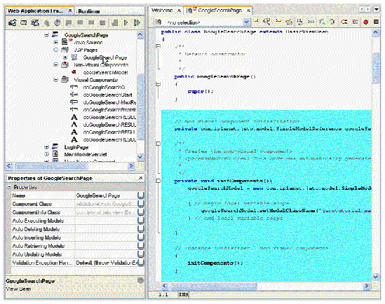

You have created the GoogleSearchViewBean.
 [ D ]
16. Rename the fields to have shorter, simpler names (select the field and click F2 to rename).
The following table shows the longer field names in the left column, and the shorter names in the right column.
doGoogleSearchQ
to queryString
doGoogleSearchStart
to start
doGoogleSearchMaxResults
to max
doGoogleSearchRestrict
to restrict
doGoogleSearchRESULTSSearchTime
to searchTime
doGoogleSearchRESULTSStartIndex
to startIndex
doGoogleSearchRESULTSEndIndex
to endIndex
doGoogleSearchRESULTSEstimatedTotalResultsCount
to estTotal

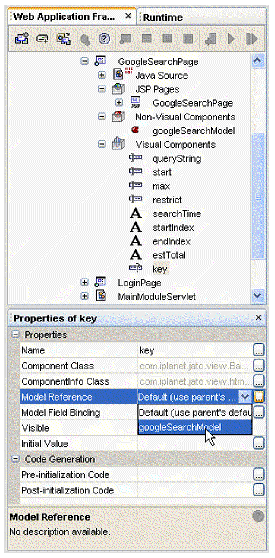

1. Select the GoogleSearchPage.
2. Add a Basic Hidden Field using the Component Palette.
The default name is hidden1.
3. Rename the default as key.

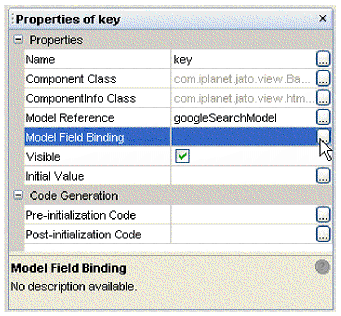

4. Set the Model Reference property for the key field.
This figure shows the Basic Hidden Field renamed as key.
5. Select googleSearchModel from the drop down list.
6. Set the Model Field Binding property.
This figure shows the Model Field Binding property option.

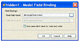

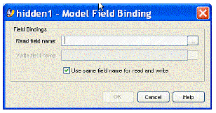

7. Click the ellipsis button to launch the Model Field Binding editor.
This figure shows the Model Field Binding editor.
8. Click the ellipsis button for the Read field name property in this editor.
This figure shows the Choose a Model Field editor.

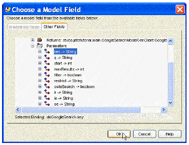

9. Expand the doGoogleSearch operation node, then expand the Parameters node.
10. Select key -> String.
11. Click OK.
The read and write fields are populated with the doGoogleSearch.key model field.
This figure shows the populated Read field name and Write field name fields in the Model Field Binding editor.
12. Click OK to finish setting the Model Field Binding property for the key hidden display field.

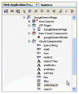

Your GoogleSearch Page node structure should look something the following figure:
This figure shows the GoogleSearchPage node structure.

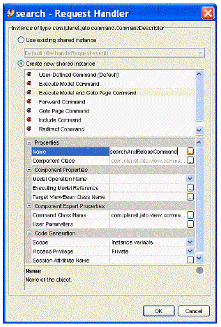

Point & Click Technique (code-free)
1. Select the search button.
2. Launch the editor for its Request Handler property by clicking the ellipsis button.
This figure shows the Request Handler editor.
3. Select the Execute Model and Goto Page Command option.
4. Set the Name to searchAndReloadCommand.
On the Component Properties tab, you need to set all three properties.
This figure shows the Component Properties tab.

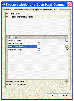

5. For the Executing Model Reference property, launch its editor by clicking the ellipsis button.
This figure shows the Executing Model Reference editor.
6. Select the Model Reference (Default) option.
7. Launch the Model Class Name property editor.
8. Browse and select the GoogleSearchModel.
9. When you return to the editor above, and the Model Class Name property is set properly, click OK.

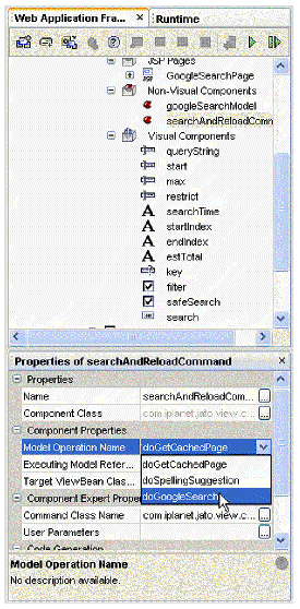

The Model Operation Name is a drop down control.
This figure shows the Model Operation Name property and its options.
10. Select doGoogleSearch from its option list.

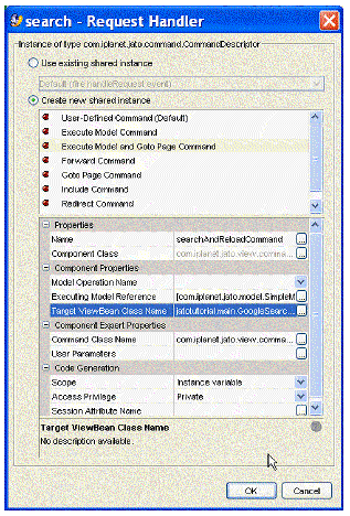

11. Launch the Target ViewBean Class Name editor.
12. Browse and choose the GoogleSearchPage.
This figure shows the Request Invocation Command editor.
13. Click OK to finish setting the button's Request Handler property.
An addition to the GoogleSearchPage's Non-Visual Components node displays: searchAndReloadCommand.
