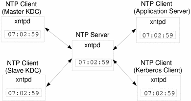

2. (Optional) Install NTP | In order for SEAM to work properly, the clocks on all systems in the realm must be kept in sync. | "Synchronizing Clocks between KDCs and SEAM Clients" |

Optional: Synchronize the master KDCs clock using NTP or another clock synchronization mechanism.
It is not necessary to install and use NTP, but every clock must be within default time defined in the libdefaults section of the krb5.conf file in order for authentication to succeed. See "Synchronizing Clocks between KDCs and SEAM Clients" for information about NTP.

Optional: On the new slave, synchronize the master KDCs clock using NTP or another clock synchronization mechanism.
It is not necessary to install and use NTP, but every clock must be within the default time defined in the libdefaults section of the krb5.conf file in order for authentication to succeed. See "Synchronizing Clocks between KDCs and SEAM Clients" for information about NTP.

All hosts participating in the Kerberos authentication system must have their internal clocks synchronized within a specified maximum amount of time (known as clock skew), which provides another Kerberos security check. If the clock skew is exceeded between any of the participating hosts, client requests will be rejected.
The clock skew also determines how long application servers must keep track of all Kerberos protocol messages, in order to recognize and reject replayed requests. So, the longer the clock skew value, the more information that application servers have to collect.
The default value for the maximum clock skew is 300 seconds (five minutes), which you can change in the libdefaults section of the krb5.conf file.
For security reasons, do not increase the clock skew beyond 300 seconds.
Since it is important to maintain synchronized clocks between the KDCs and SEAM clients, it is recommended that you use the Network Time Protocol (NTP) software to do this. The Network Time Protocol (NTP) public domain software from the University of Delaware is included in the Solaris software starting with the Solaris 2.6 release.
Another way to synchronize clocks is to use the rdate command and cron jobs, which can be a less involved process than using NTP. However, this section will continue to focus on using NTP. And, if you use the network to synchronize the clocks, the clock synchronization protocol must itself be secure.
NTP enables you to manage precise time and/or network clock synchronization in a network environment. NTP is basically a server/client implementation. You pick one system to be the master clock (NTP server), and then you set up all your other systems to synchronize their clocks with the master clock (NTP clients). This is all done through the xntpd daemon, which sets and maintains a UNIX system time-of-day in agreement with Internet standard time servers. Figure 3-1 shows an example of the using the server/client NTP implementation.
To ensure that the KDCs and SEAM clients maintain synchronized clocks, implement the following steps:
Set up an NTP server on your network (this can be any system except the master KDC). See "How to Set Up an NTP Server".
As you configure the KDCs and SEAM clients on the network, set them up to be NTP clients of the NTP server. See "How to Set Up an NTP Client".

Change to the /etc/inet directory.
Copy the ntp.client file to the ntp.conf file.
# cp ntp.client ntp.conf |
Change to the /etc/init.d directory.
Start the xntpd daemon.
# ./xntpd start |

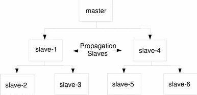

In most cases, the master KDC is used exclusively to propagate its database to the slave KDCs. However, if your site has a lot of slave KDCs, you might want to consider load-sharing the propagation process, known as parallel propagation.
Parallel propagation allows specific slave KDCs to share the propagation duties with the master KDC. This enables the propagation to be done faster and to lighten the work for the master KDC.
For example, say your site has one master and six slaves (shown in Figure 3-2), where slave-1 through slave-3 consist of one logical grouping and slave-4 through slave-6 consist of the other. To set up parallel propagation, you could have the master KDC propagate the database to slave-1 and slave-4, and those slaves could in turn propagate the database to the slaves in their group.
This is not a detailed step-by-step procedure, but a high-level list of configuration steps to enable parallel propagation.
On the master KDC, change the kprop_script entry in its cron job to include arguments for only the slaves that will perform the succeeding propagation (propagation slaves).
On each propagation slave, add a kprop_script entry to its cron job, which must include arguments for the slaves to propagate. To successfully propagate in parallel, the cron job should be set up to run after the propagation slave is itself propagated with the new database.
Determining how long it will take for a propagation slave to be propagated depends on factors such as network bandwidth and the size of the database.
On each slave KDC, set up the appropriate permissions to be propagated. This is done by adding the host principal name of its propagating KDC to its kpropd.acl file.
Using the example in Figure 3-2, the master KDC's kprop_script entry would look something like this:
10 3 * * * /usr/krb5/lib/kprop_script slave-1.acme.com slave-4.acme.com
slave-1's kprop_script entry would look something like this (note that the propagation on the slave starts an hour after it is propagated by the master):
10 4 * * * /usr/krb5/lib/kprop_script slave-2.acme.com slave-3.acme.com
The kpropd.acl file on the propagation slaves would have to contain the following entry:
host/master.acme.com@ACME.COM
The kpropd.acl file on the slaves being propagated by slave-1 would have to contain the following entry:
host/slave-1.acme.com@ACME.COM
