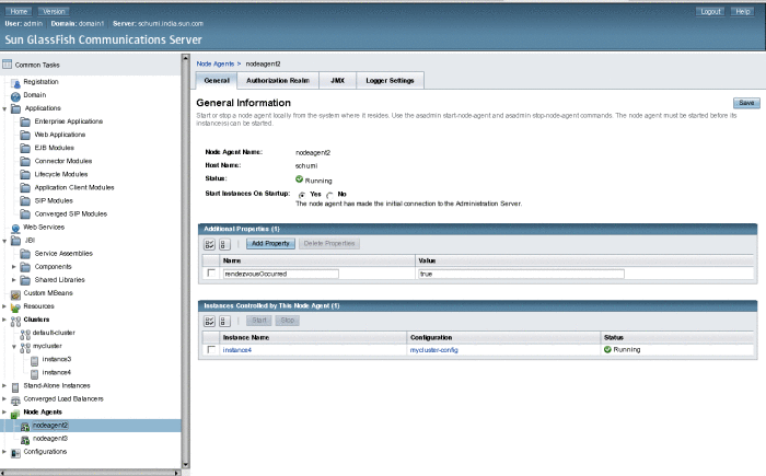

Create and start a node agent (nodeagent2) on the DAS machine.
Use the following command: asadmin create-node-agent --user admin --host schumi nodeagent2
Start the node agent on the DAS machine.
Use the following command: asadmin start-node-agent --user admin --host schumi nodeagent2. For more information, see start-node-agent(1) command.

Log in to the Admin Console of the DAS machine at http:// das-machine-name:portnumber.
You can see that the two node agents are running if you click Node Agents on the left-hand tree on the Admin Console.

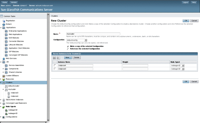

On the left pane, click the Clusters tab and click New.
Specify a name for the cluster.
This example creates a cluster with the name, mycluster.
In the Server Instances to be Created section, click New.
Type the instance name as instance3 and choose node agent, nodeagent3.
nodeagent3 was created on the machine called sr115 in step 2 of this procedure.
Type the instance name as instance4 and choose node agent, nodeagent2.
nodeagent2 was created on the DAS machine called schumi in step 1 of this procedure.
Click OK.
The cluster gets created.

The two instances in mycluster are running on different machines and are controlled by different node agents. You can view the two node agents and see each instance associated with it.
