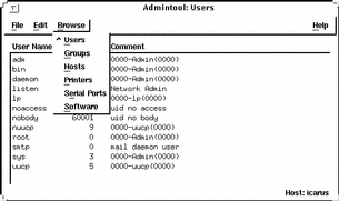

  5. Use the Browse menu option to select the type of work you want to do with Admintool. You can select Users, Groups, Hosts, Printers, Serial Ports, and Software, as illustrated in the next screen.
    Graphic
