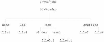

For each package, organize package objects into a directory structure beneath their corresponding package directory, which mimics how they will be located on the target system.
For example, the CAD application package, SUNWcadap, requires the following directory structure.

If you want to create a prototype file from scratch, you can do so with your favorite text editor, adding one entry per package object. See "The Format of the prototype File" and the prototype(4) man page for more information on the format of the file. However, after you have defined each package object, you might want to include some of the features described in "Adding Functionality to a prototype File".
You can use the pkgproto command to build a basic prototype file, as long as you have organized your package directory structure as described in "Organizing a Package's Contents". For example, using the sample directory structure and pkginfo file described in previous sections, the commands for creating the prototype file are:
$ cd /home/jane $ pkgproto ./SUNWcadap > InfoFiles/prototype |
The prototype file looks like:
d none SUNWcadap 0755 jane staff d none SUNWcadap/demo 0755 jane staff f none SUNWcadap/demo/file1 0555 jane staff d none SUNWcadap/srcfiles 0755 jane staff f none SUNWcadap/srcfiles/file5 0555 jane staff f none SUNWcadap/srcfiles/file6 0555 jane staff d none SUNWcadap/lib 0755 jane staff f none SUNWcadap/lib/file2 0644 jane staff d none SUNWcadap/man 0755 jane staff f none SUNWcadap/man/windex 0644 jane staff d none SUNWcadap/man/man1 0755 jane staff f none SUNWcadap/man/man1/file4.1 0444 jane staff f none SUNWcadap/man/man1/file3.1 0444 jane staff |
The actual owner and group of the person building the package is recorded by the pkgproto command. A good technique is to use the chown -R and the chgrp -R commands, setting the owner and group as intended before running the pkgproto command.
This prototype file is not yet complete. See "Fine-Tuning a prototype File Created With the pkgproto Command" for information on completing this file.

Given the prototype file created by the pkgproto command in "Creating a prototype File With the pkgproto Command", there are several modifications that need to be made.
There needs to be an entry for the pkginfo file.
The path fields need to be modified to be the path1=path2 format, since the package source is in /home/jane. (Since the package source is a hierarchical directory, and the !search command does not search recursively, it may be easier to use the path1=path2 format.)
The owner and group fields should contain the names of existing users and groups on the target system. That is, the owner jane will result in an error since this owner is not part of the SunOSTM operating system.
The modified prototype file looks like:
i pkginfo=/home/jane/InfoFiles/pkginfo d none SUNWcadap=/home/jane/SUNWcadap 0755 root sys d none SUNWcadap/demo=/home/jane/SUNWcadap/demo 0755 root bin f none SUNWcadap/demo/file1=/home/jane/SUNWcadap/demo/file1 0555 root bin d none SUNWcadap/srcfiles=/home/jane/SUNWcadap/srcfiles 0755 root bin f none SUNWcadap/srcfiles/file5=/home/jane/SUNWcadap/srcfiles/file5 0555 root bin f none SUNWcadap/srcfiles/file6=/home/jane/SUNWcadap/srcfiles/file6 0555 root bin d none SUNWcadap/lib=/home/jane/SUNWcadap/lib 0755 root bin f none SUNWcadap/lib/file2=/home/jane/SUNWcadap/lib/file2 0644 root bin d none SUNWcadap/man=/home/jane/SUNWcadap/man 0755 bin bin f none SUNWcadap/man/windex=/home/jane/SUNWcadap/man/windex 0644 root other d none SUNWcadap/man/man1=/home/jane/SUNWcadap/man/man1 0755 bin bin f none SUNWcadap/man/man1/file4.1=/home/jane/SUNWcadap/man/man1/file4.1 0444 bin bin f none SUNWcadap/man/man1/file3.1=/home/jane/SUNWcadap/man/man1/file3.1 0444 bin bin |
