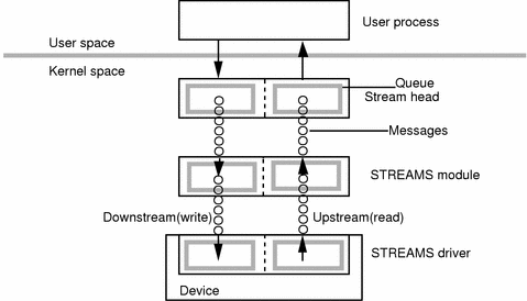

A Stream is a data path, that passes data in both directions between a STREAMS driver in kernel space, and a process in user space. An application creates a Stream by opening a STREAMS device (see Figure 1-1).
Stream-Head
A Stream-head is the end of the Stream nearest the user process. It is the interface between the Stream and the user process. When a STREAMS device is first opened, the Stream consists of only a Stream head and a STREAMS driver.

A STREAMS module is a defined set of kernel-level routines and data structures. A module does "black-box" processing on data that passes through it. For example, a module converts lowercase characters to uppercase, or adds network routing information. A STREAMS module is dynamically pushed on the Stream from user level by an application. Full details on modules and their operation are covered in Chapter 10, Modules.

A character device driver that implements the STREAMS interface. A STREAMS device driver exists below the Stream head and any modules. It can act on an external I/O device, or it can be an internal software driver, called a pseudo-device driver. The driver transfers data between the kernel and the device. The interfaces between the driver and kernel are known collectively as the Solaris 2.x Device Driver Interface/Driver Kernel Interface (Solaris 2.x DDI/DKI). The relationship between the driver and the rest of the UNIX kernel is explained in Writing Device Drivers. Details of device drivers are explained in Chapter 9, STREAMS Drivers.

The means by which all I/O is done under STREAMS. Data on a Stream is passed in the form of messages. Each Stream head, STREAMS module, and driver has a read side and a write side. When messages go from one module's read side to the next module's read side they are said to be traveling upstream. Messages passing from one module's write side to the next module's write side are said to be traveling downstream. Kernel-level operation of messages is discussed on "Messages".

A container for messages. Each Stream head, driver, and module has its own pair of queues, one queue for the read side and one queue for the write side. Messages are ordered into queues, generally on a first-in, first-out basis (FIFO), according to priorities associated with them. Kernel-level details of queues are covered on "Queues".
Figure 1-2 Messages Passing Using Queues
