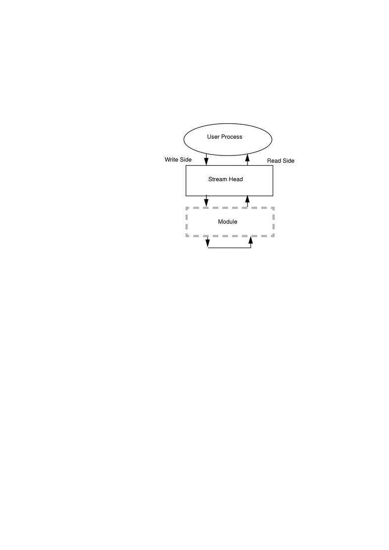

FIFOs are unidirectional: that is, one end of the FIFO is used for writing the data, the other for reading data. FIFOs allow simple one-way interprocess communication between unrelated processes. Modules may be pushed onto a FIFO. Data written to the FIFO is passed down the write side of the module and back up the read side.
FIFOs are opened in the same manner as other file system nodes with open(2). Any data written to the FIFO can be read from the same file descriptor in the first-in first-out manner (serial, sequentially). Modules can also be pushed on the FIFO. See open(2) for the restrictions that apply when opening a FIFO. If O_NDELAY or O_NONBLOCK are not specified, an open on a FIFO blocks until both a reader and a writer are present.

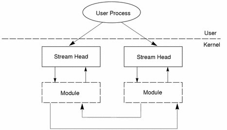

A STREAMS-based pipe, also referred to as an anonymous pipe, is created using pipe(2). pipe(2) returns two file descriptors--fd[0] and fd[1], each with its own Stream head. The ends of the pipe are so constructed that data written to either end of a pipe may be read from the opposite end.
STREAMS modules can be added to a pipe with I_PUSH ioctl(2). A module can be pushed onto one or both ends of the pipe (see Figure 6-2). However, if a module is pushed onto one end of the pipe, that module cannot be popped from the other end.

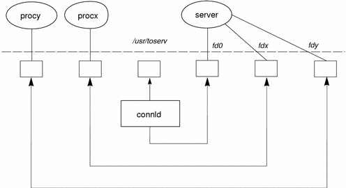

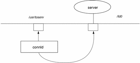

With named pipes, client processes may communicate with a server process using the module connld that lets a client process get a unique, non-multiplexed connection to a server. The connld(7M) module can be pushed onto the named end of the pipe. If the named end of the pipe is then opened by a client, a new pipe is created. One file descriptor for the new pipe is passed back to a client (named Stream) as the file descriptor from open(2) and the other file descriptor is passed to the server using I_RECUFD ioctl(2). The server and the client may then communicate through a new pipe.
Figure 6-3 illustrates a server process that has created a pipe and pushed the connld module on the other end. The server then invokes the fattach(3C) routine to name the other end /usr/toserv.
When process X (procx) opens /usr/toserv, it gains a unique connection to the server process that was at one end of the original STREAMS-based pipe. When process Y (procy) does the same, it also gains a unique connection to the server. As shown in Figure 6-4, the server process has access to three separate pipes through three file descriptors.
