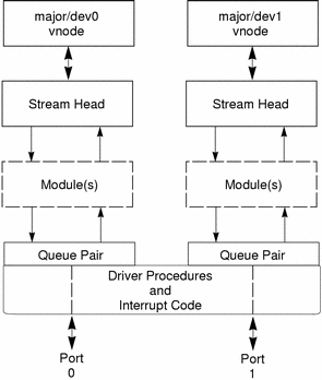

This chapter describes how STREAMS multiplexing configurations are created and also discusses multiplexing drivers. A STREAMS multiplexer is a driver with multiple Streams connected to it. The primary function of the multiplexing driver is to switch messages among the connected Streams. Multiplexer configurations are created from user level by system calls.
STREAMS-related system calls are used to set up the "plumbing," or Stream interconnections, for multiplexing drivers. The subset of these calls that allows a user to connect (and disconnect) Streams below a driver is referred to as the multiplexing facility. This type of connection is referred to as a one-to-M, or lower, multiplexer configuration. This configuration must always contain a multiplexing driver, which is recognized by STREAMS as having special characteristics.
Multiple Streams can be connected above a driver by open(2) calls. This was done for the loop-around driver and for the driver handling multiple minor devices in Chapter 9, STREAMS Drivers. There is no difference between the connections to these drivers. Only the functions performed by the driver are different. In the multiplexing case, the driver routes data between multiple Streams. In the device driver case, the driver routes data between user processes and associated physical ports. Multiplexing with Streams connected above is referred to as an N-to-1, or upper, multiplexer. STREAMS does not provide any facilities beyond open(2) and close(2) to connect or disconnect upper Streams for multiplexing.
From the driver's perspective, upper and lower configurations differ only in the way they are initially connected to the driver. The implementation requirements are the same: route the data and handle flow control. All multiplexer drivers require special developer-provided software to perform the multiplexing data routing and to handle flow control. STREAMS does not directly support flow control among multiplexed Streams. M-to-N multiplexing configurations are implemented by using both of these mechanisms in a driver.
As discussed in Chapter 9, STREAMS Drivers, the multiple Streams that represent minor devices are actually distinct Streams in which the driver keeps track of each Stream attached to it. The STREAMS subsystem does not recognize any relationship between the Streams. The same is true for STREAMS multiplexers of any configuration. The multiplexed Streams are distinct and the driver must be implemented to do most of the work.
In addition to upper and lower multiplexers, more complex configurations can be created by connecting Streams containing multiplexers to other multiplexer drivers. With such a diversity of needs for multiplexers, it is not possible to provide general-purpose multiplexer drivers. Rather, STREAMS provides a general purpose multiplexing facility. The facility allows users to set up the intermodule or driver plumbing to create multiplexer configurations of generally unlimited interconnection.

First, there is a check to enforce that the Stream associated with minor device 0 will be the single, controlling Stream. The ioctl(2)s are only accepted on this Stream. As described previously, a controlling Stream is the one that issues the I_LINK. Having a single control Stream is a recommended practice. I_LINK and I_UNLINK include a linkblk structure containing:
l_qtop
The upper write queue from which the ioctl(2) is coming. It always equals q for an I_LINK, and NULL for I_PLINK.
l_qbot
The new lower write queue. It is the former Stream-head write queue. It is of most interest since that is where the multiplexer gets and puts its data.
l_index
A unique (system-wide) identifier for the link. It can be used for routing or during selective unlinks. Since the example only supports a single link, l_index is not used.
For I_LINK, l_qbot is saved in muxbot and a positive acknowledgment is generated. From this point on, until an I_UNLINK occurs, data from upper queues will be routed through muxbot. Note that when an I_LINK, is received, the lower Stream has already been connected. This allows the driver to send messages downstream to perform any initialization functions. Returning an M_IOCNAK message (negative acknowledgment) in response to an I_LINK causes the lower Stream to be disconnected.
The I_UNLINK handling code nulls out muxbot and generates a positive acknowledgment. A negative acknowledgment should not be returned to an I_UNLINK. The Stream head assures that the lower Stream is connected to a multiplexer before sending an I_UNLINK M_IOCTL.
Drivers can handle the persistent link requests--I_PLINK and I_PUNLINK ioctl(2)s (see "Persistent Links") in the same manner, except that l_qtop in the linkblk structure passed to the put routine is NULL instead of identifying the controlling Stream.
muxuwput handles M_FLUSH messages as a normal driver would, except that there are no messages queued on the upper read queue, so there is no need to call flushq if FLUSHR is set.
M_DATA messages are not placed on the lower write message queue. They are queued on the upper write message queue. When flow control subsides on the lower Stream, the lower service procedure, muxlwsrv, is scheduled to start output. This is similar to starting output on a device driver.
The following example shows the code for the upper multiplexer write service procedure:
static int muxuwsrv(queue_t *q)
mblk_t *mp;
struct mux *muxp;
muxp = (struct mux *)q->q_ptr;
if (!muxbot) {
flushq(q, FLUSHALL);
return (0);
if (muxerr) {
return (0);
while (mp = getq(q)) {
if (canputnext(muxbot))
putnext(muxbot, mp);
else {
putbq(q, mp);
return(0);
return (0);
As long as there is a Stream still linked under the multiplexer and there are no errors, the service procedure will take a message off the queue and send it downstream, if flow control allows.
muxlwsrv, the lower (linked) queue write service procedure is scheduled as a result of flow control subsiding downstream (it is back-enabled).
static int muxlwsrv(queue_t *q)
int i;
for (i = 0; i < mux_cnt; i++)
if (mux_mux[i].qptr && mux_mux[i].qptr->q_first)
qenable(mux_mux[i].qptr);
return (0);
muxlwsrv steps through all possible upper queues. If a queue is active and there are messages on the queue, then its upper write service procedure is enabled through qenable.
