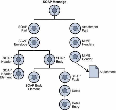

A SOAP Message Object is a tree of objects as shown in Figure 5–5. The classes or interfaces from which these objects are derived are all defined in the javax.xml.soap package.
As shown in the figure, the SOAPMessage object is a collection of objects divided in two parts: a SOAP part and an attachment part. The main thing to remember is that the attachment part can contain non-xml data.
The SOAP part of the message contains an envelope that contains a body (which can contain data or fault information) and an optional header. When you use SAAJ to create a SOAP message, the SOAP part, envelope, and body are created for you: you need only create the body elements. To do that you need to get to the parent of the body element, the SOAP body.
In order to reach any object in the SOAPMessage tree, you must traverse the tree starting from the root, as shown in the following lines of code. For example, assuming the SOAPMessage is MyMsg, here are the calls you would have to make in order to get the SOAP body:
SOAPPart MyPart = MyMsg.getSOAPPart(); SOAPEnvelope MyEnv = MyPart.getEnvelope(); SOAPBody MyBody = envelope.getBody();
At this point, you can create a name for a body element (as described in Namespaces) and add the body element to the SOAPMessage.
For example, the following code line creates a name (a representation of an XML tag) for a body element:
Name bodyName = envelope.createName("Temperature");
The next code line adds the body element to the body:
SOAPBodyElement myTemp = MyBody.addBodyElement(bodyName);
Finally, this code line defines some data for the body element bodyName :
myTemp.addTextNode("98.6");
