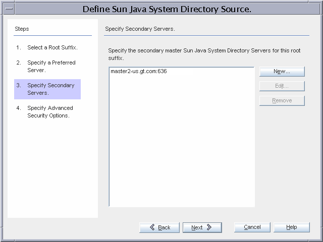

master2-us.gt.com is chosen as the secondary Directory Server. The connector communicates with Directory Server over SSL.

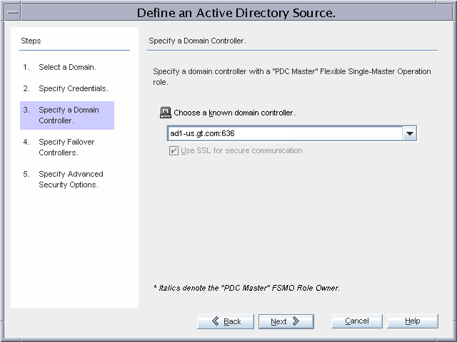

ad1-us.gt.com is the PDC FSMO role owner and is selected as the domain with which the controller for the Active Directory Connector will communicate. The connector communicates over SSL.

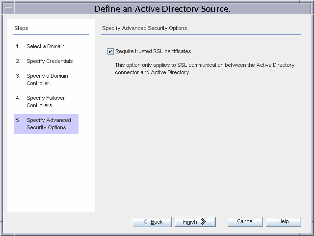

Because Global Telco requires the strictest security possible, the Active Directory Connector will require a trusted SSL certificate from ad1-us.gt.com.
Enabling this advanced security option implies additional installation steps as outlined below.

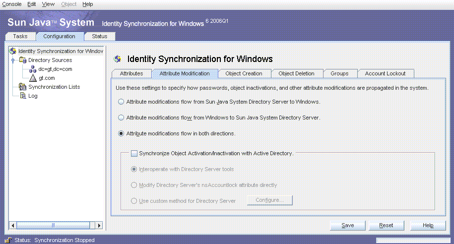

The only default global setting that is changed is the synchronization of attribute modifications from Active Directory to Directory Server, and from Directory Server to Active Directory.

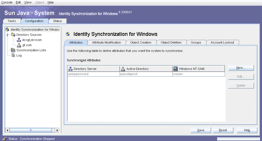

Only passwords are synchronized. No additional attributes are synchronized.

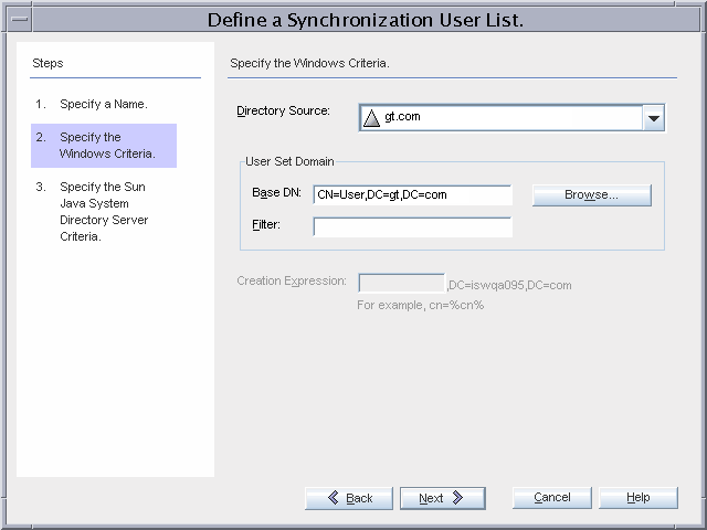

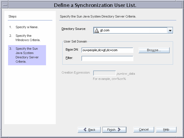

A single SUL, GT_USERS, is created as shown in Primary Installation.
Active Directory users are stored under the default cn=users,dc=gt,dc=com container. The existing users (Administrator, Guest, TsInternetUser, and iswUser) are excluded from synchronization.
The Directory Server users are stored in the default ou=people,dc=gt,dc=com container.

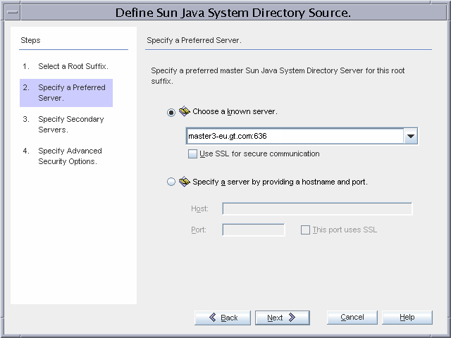

master3-eu.gt.com is the preferred Directory Server in the failover installation.
master4-eu.gt.com is the secondary Directory Server in the failover installation.
ad3-eu.gt.com is chosen as the domain controller with which the Active Directory Connector will communicate.
Note that a warning will be displayed stating that the password updates might become slow because ad3-eu.gt.com is not the PDC FSMO role owner. This warning can be ignored because changing the PDC FSMO role to this domain controller is part of the failover procedure. A similar warning is also displayed when the configuration is saved.

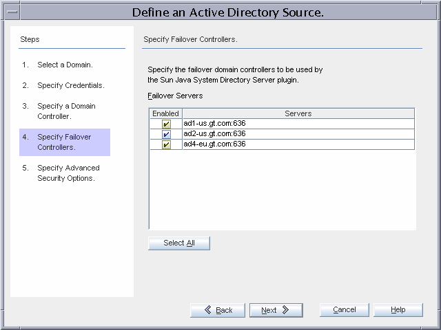

The remaining domain controllers are selected for failover during on-demand password synchronization.

Connector ID: CNN101 Type: Active Directory Manages: gt.com (ldaps://ad1-us.gt.com:636) (ldaps://ad2-us.gt.com:636) (ldaps://ad4-eu.gt.com:636) (ldaps://ad3-eu.gt.com:636) State: READY Installed on: connectors-eu.gt.com Sun Java(TM) System Message Queue Status: Started Checking the System Manager status over the Sun Java(TM) System Message Queue. System Manager Status: Started Remaining Installation and Configuration Steps: 1. Install the Sun Directory Server Plugin at master ldaps://master3-eu.gt.com:636 by re-running the installer. 2. Install the Sun Directory Server Plugin at master ldaps://master4-eu.gt.com:636 by re-running the installer. 3. Install the Sun Directory Server Plugin on every other master and read-only replica that manage users under dc=gt,dc=com. 4. Run 'idsync resync' to establish links between existing Directory Server and Windows users. 5. Start synchronization using the console or the 'idsync startsync' command. SUCCESS
