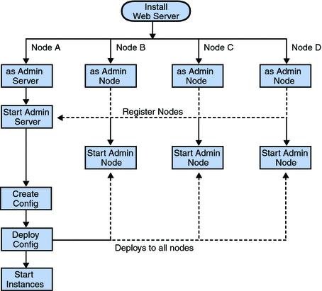

This section describes the procedure to set up the cluster and enable reverse proxy to support load-balancing of HTTP requests.
The following flowchart illustrates the procedure to set up a cluster.
On one of the nodes, install Web Server that acts as the Administration Server in a cluster.
On other three nodes, install Web Server. Select the option of installing Web Server as an Administration Node. During the installation, choose the option of registering the node with the server.
Make sure the Administration Server is using SSL port for communication, as an Administration Node can be registered with the server only in secure mode.
Make sure the system date and time on all the nodes where the Administration Server and the Administration Nodes are installed are the same. The certificate associated with the server is created based on the system date and time of the node where the Administration Server is installed. If the system date of the Administration Node is earlier than the Administration Server, the registration fails as the certificate of the Administration Server will not yet be valid. As a corollary, the certificate may be deemed valid if it is has expired.

Start all the Administration Nodes using the startserv command from the install_dir/admin-server/bin/ directory.
Using the Admin Console or the CLI, create a new configuration in the Administration Server.
Provide configuration information such as configuration name, HTTP Listener port, and the server name for the new configuration.
Create instances of the configuration on all the nodes.
Start the instances on all the nodes.
