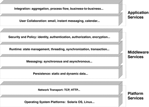

Infrastructure Service Levels
In designing a distributed software system, whether it consists mostly of custom-developed components or out-of-the-box Java ES components, you need to incorporate a number of infrastructure services. These services operate at many levels.
The infrastructure service dependencies of solution architecture are illustrated in Figure 2–2. The levels shown in this figure are an expanded view of the infrastructure service layer of Figure 1–1. The hierarchy of services in Figure 2–2 and the dependencies between them constitute an important dimension of a solution’s logical architecture. These infrastructure services provide the main rationale for Java ES system service components (see System Service Components).
In general, the services shown in the following figure divide into three broad groupings: low-level platform services, high-level application services, and a group of middleware services named for their location between the other two groupings.
Figure 2–2 Dimension 1: Infrastructure Service Levels
Diagram showing distributed service infrastructure levels
from lowest level operating system platform services to highest level integration
services.
The following descriptions of the different infrastructure service levels refer to Java programming language artifacts, where relevant, and are listed from lowest to highest, as shown in Figure 2–2:
The service levels shown in Figure 2–2 reflect a dependence of the infrastructure services on one another, from the lowest-level operating system services to the highest-level application and integration services. Each service generally depends on services below it and supports services above it. Figure 2–2, however, does not represent a strict layering of infrastructure services. Higher-level services can directly interact with lower-level services without depending on intermediate levels. For example, some runtime services might depend directly on platform services without requiring any of the service levels in between. In addition, other service levels, such as a monitoring or management service, might also be included in this conceptual illustration.

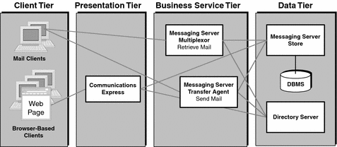

Tiered Architecture Applied to System Components
As shown in Figure 2–3, Java ES infrastructure service components provide the underlying infrastructure support for distributed software solutions. Some of these solutions include application-level services provided by Sun Java Communications Suite components and some Java ES components. These solutions use logical tier design approaches.
For example, the email communication services provided by Messaging Server are implemented using a number of logically distinct configurations of Messaging Server. These distinct configurations each provide a distinct set of services. When designing messaging solutions, these distinct configurations are represented as separate components that are situated in different logical tiers, as shown in the following figure where lines connecting components represent interactions.
Note –
The following figure is not meant to be a complete logical architecture. A number of Java ES components are omitted to simplify the illustration.
Figure 2–5 Messaging Server: Example of Tiered Architecture
Diagram showing Messaging Server components distributed
among the four logical tiers.
Note –
Communications components are not part of Java ES but are often deployed with Java ES components and used within Java ES architectures. These communications components are part of the Sun Java Communications Suite and are referenced in this document for illustrative purposes only.
The logical separation of Messaging Server functions into different tiers allows the logically distinct configurations of Messaging Server to be deployed on different computers in a physical environment. The physical separation allows for flexibility in meeting quality of service requirements (see Dimension 3: Quality of Service). For example, it provides for different availability solutions for the different instances, and different security implementations for different Messaging Server functions.
