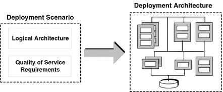

A deployment architecture is created by mapping the logical building blocks of an application (the logical architecture) to a physical computing environment in a way that meets the quality of service requirements specified in the deployment scenario. The deployment scenario is translated into a deployment architecture, as shown in the following figure.
Figure 4–3 Translating a Deployment Scenario into a Deployment Architecture
Diagram showing how a deployment scenario translates
into a deployment architecture.
One aspect of this architectural design is sizing the physical environment (determining the number of computers and estimating their processor power and RAM requirements) to meet performance, availability, security, and other quality of service requirements. Once the sizing is complete, you map Java ES components and application components to the various computers in the physical environment. The resulting deployment architecture must take into account the capabilities of different computers, characteristics of system infrastructure services, and restrictions on the total cost of ownership or total cost of availability.
