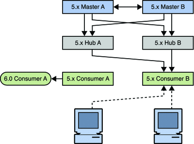

The following sequence of diagrams illustrate the migration of a consumer, as described above. The first diagram shows the version 5 topology before the migration.
The first step involves rerouting clients and disabling replication agreements, effectively isolating the consumer from the topology.
The next step involves migrating the version 5 consumer.
The next step involves enabling the replication agreements to the new consumer, initializing the consumer if necessary, and rerouting client applications to the new consumer.

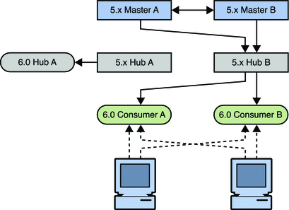

The following sequence of diagrams illustrate the migration of a hub, as described above. The first diagram shows the topology before migrating the hubs.
The first migration step involves disabling replication agreements, effectively isolating the hub from the topology.
The next step involves migrating the version 5 hub.
The next step involves enabling the replication agreements to the new hub and initializing the hub if necessary.
Check that the replication on the consumers is in sync with the rest of the topology before migrating another hub. A server that has just been migrated does not have a change log, and can therefore not update consumer servers that are out of sync. Allow the topology to stabilize and all servers to synchronize before migrating the next supplier server.

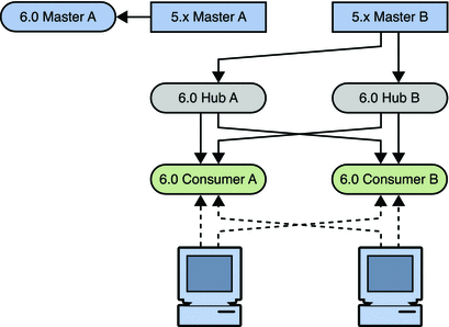

The following sequence of diagrams illustrate the migration of a master, as described above. The first diagram shows the version 5 topology before the migration of the masters.
The first step in migrating a master involves disabling replication agreements, effectively isolating the master from the topology.
The next step involves migrating the version 5 master.
The next step involves enabling the replication agreements to and from the new master and initializing the master if necessary.
Check that the replication on all hubs and consumers is in sync with the rest of the topology before migrating another master. A server that has just been migrated does not have a change log, and can therefore not update servers that are out of sync. Allow the topology to stabilize and all servers to synchronize before migrating the next supplier server.
