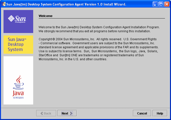

After the Configuration Agent Install Wizard has been called, a Welcome page appears. The Welcome page provides you with information regarding the installation process.
Click the Next button to proceed to the next page in the wizard.

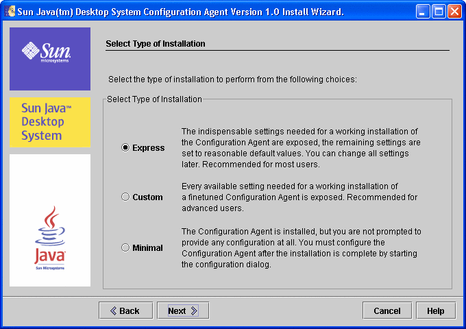

The installer provides three installation types. These types only differ in the number of configuration settings that can be defined during the installation process.
Express: The express type is recommended for most users. The installer only exposes the indispensable settings that are needed for a working installation of the Configuration Agent. All remaining settings are set to reasonable defaults.
Custom: All available settings for the Configuration Agent are exposed, which allows you to fine-tune the agent's behavior. This type is only recommended for advanced users.
Minimal: The Configuration Agent is installed, but you are not prompted to provide any configuration at all. You must configure the Configuration Agent after the installation has been completed by starting the configuration wizard.
After selecting the desired installation type, click Next. Depending on the selected installation type, several configuration settings pages are displayed. The following section provides a description for these settings.

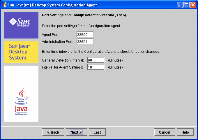

The Configuration Agent uses two ports:
Agent Port (DaemonPort): used by the agent to communicate with client applications (default is 38900).
Administration Port (DaemonAdminPort): used by the agent controller program, apocd.exe, when communicating with the agent (default is 38901).
The Configuration Agent periodically checks for any changes in the configuration data using the following two intervals:
General Detection Interval (ChangeDetectionInterval): interval in minutes between the change detection cycles for the desktop application's (client's) configuration data.
Specifying -1 turns off change detection.
Interval for Agent Settings (DaemonChangeDetectionInterval): interval in minutes between the change detection cycles for the agent-specific configuration settings.
You can use the general detection interval to tune the propagation of remote configuration data changes to client side applications. The value provided for this setting is the maximum length of time in minutes that elapses before remotely made changes are reflected in the client applications.
Smaller values result in increased Configuration Agent and LDAP server activity. As a result, use caution when you adjust the value of the settings. For example, in an initial deployment phase, you can set the value to one minute so that you can easily test the impact of remote configuration on client applications. After you complete the testing, return this setting to the initial value.

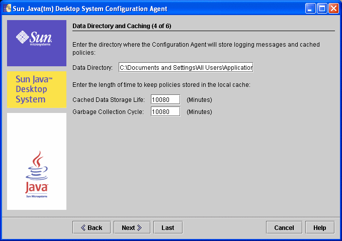

Data Directory (DataDir): the directory used to store runtime data.
Cached Data Storage Life (TimeToLive): interval in minutes that non-offline configuration data remains in the local database.
Garbage Collection Cycle (GarbageCollectionInterval): interval in minutes between the garbage collection cycles in the local configuration database.

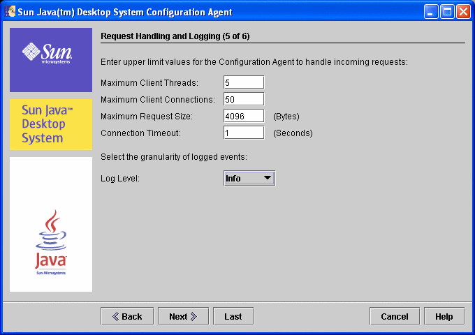

Maximum Client Threads (MaxClientThreads): maximum number of client requests that can be processed simultaneously.
Maximum Client Connections (MaxClientConnections): maximum number of client connections.
Maximum Request Size (MaxRequestSize): maximum size of client requests.
Connection Timeout (ConnectTimeout): denotes the allowed interval of the LDAP server to answer a connection request. The default is one second.
Log Level (LogLevel): level of detail in the agent log files. The logging level is consistent with the Java Logger levels. In order of decreasing severity, these levels are:
OFF
SEVERE
WARNING
INFO
CONFIG
FINE
FINER
FINEST
ALL

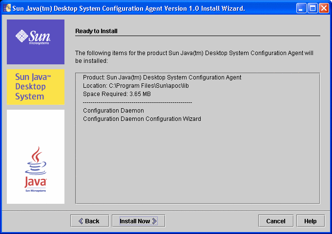

The Ready to Install page shows you what items for the Configuration Agent are to be installed.
At this point, no changes have yet been made on your system. The actual installation starts when you click the Install Now button.

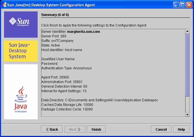

The Installation Summary page of the wizard shows the status of the installed items. Click the Details button next to the corresponding item to provide more information about that item.
