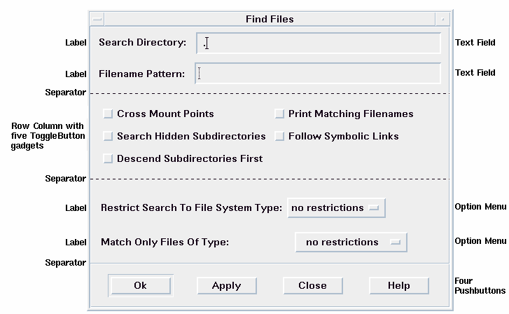

The script's window allows you to specify a search directory and a file name. Other options allow you to place restrictions on the type of file system to search and the file type on which to match. Figure 4-1 shows the script's window.
Enter the search directory and file name you're looking for in the text fields at the top of the window. In addition, select any applicable choice (or choices) from the five toggle buttons. You can further restrict the search with the option menus. When you have made all the necessary selections, click OK. If all is well, a window appears shortly thereafter and displays the results of the find operation. An error dialog appears if you don't specify a search directory or file name, or if the specified search directory is invalid. For example, suppose you want to find a file called two_letter_calls, and you think it resides somewhere in the directory /users/dlm. When you enter the directory in the Search Directory text field, you inadvertently type /users/dln instead of /users/dlm. When you click OK or Apply, script_find can't find the directory /users/dln, so it creates the error dialog to notify you of this.

The script_find window (see Figure 4-4) consists of a Form widget with four areas. The areas are marked by Separator widgets, and each area has several widgets, all of which are children of the Form.
The widgets are created in sequence by area, from top to bottom.

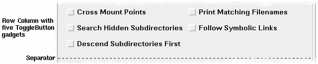

The second area consists of a RowColumn widget, five ToggleButton gadgets, and another Separator widget.
A gadget is a widget that relies on its parent for many of its attributes, thus saving memory resources.
The RowColumn widget is created as a child of the Form widget, and positioned directly under the Separator widget created in the first area.
XtCreateManagedWidget RC
rc XmRowColumn $FORM \
orientation:HORIZONTAL \
numColumns:3 \
packing:PACK_COLUMN \
$(DtkshUnder $SEP 10) \
$(DtkshSpanWidth 10 10) \
navigationType:EXCLUSIVE_TAB_GROUP
The five ToggleButton gadgets are created as children of the RowColumn using the convenience function DtkshAddButtons:
DtkshAddButtons -w $RC XmToggleButtonGadget \
T1 "Cross Mount Points" ""\
T2 "Print Matching Filenames" ""\
T3 "Search Hidden Subdirectories" ""\
T4 "Follow Symbolic Links" ""\
T5 "Descend Subdirectories First" ""
Another Separator is then created to separate the second and third areas. Note that this Separator widget ID is called SEP2.

The third area consists of two option menus and another Separator widget.
The Option Menus are pull-down menus. When the user clicks the option menu button, a menu pane with a number of choices appears. The user drags the pointer to the appropriate choice and releases the mouse button. The menu pane disappears and the option menu button label displays the new choice.
The first option menu menu pane consists of a number of push button gadgets, representing various restrictions that can be imposed upon the find command:
XmCreatePulldownMenu PANE $FORM pane
DtkshAddButtons -w $PANE XmPushButtonGadget \
NODIR "no restrictions" ""\
NFS "nfs" ""\
CDFS "cdfs" ""\
HFS "hfs" ""
Next, the Option Menu button itself is created and managed, with the
menu pane just created ($PANE) identified as a subMenuId:
XmCreateOptionMenu FSTYPE $FORM fstype \
labelString:"Restrict Search To File System Type:" \
menuHistory:$NODIR \
subMenuId:$PANE \
$(DtkshUnder $SEP2 20) \
XtManageChild $FSTYPE
The second option menu button is created in the same manner. It provides further restrictions on the find command.
The third separator is created in the same manner as the other separators.
The fourth area consists of four push button widgets, all children of the Form widget.
The four push buttons are used as follows:
OK executes the find command with the parameters input in the script_find window and removes the script_find window.
Apply executes the find command with the parameters input in the script_find window but does not remove the script_find window.
Close terminates script_find without executing the find command.
Help creates a dialog box with information on the use of script_find.
