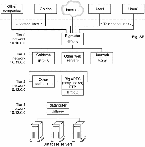

IPQoS on a Network of Server Farms
The following figure shows a network with several heterogeneous server farms.
In such a topology, the router is diffserv-aware, and therefore able to queue and rate both incoming and outgoing traffic. The load balancer is also diffserv-aware, and the server farms are IPQoS-enabled. The load balancer can provide additional filtering beyond the router by using selectors such as userID and projectID, which are included in the application data.
Figure 2–2 Network of IPQoS-Enabled Server Farms
Topology diagram shows a network with a diffserv router, an IPQoS-enabled load balancer, and three server farms.
This scenario provides flow control and traffic forwarding to manage congestion on the local network. The topology also prevents outgoing traffic from the server farms from overloading other portions of the intranet.

Example—IPQoS Topology
The following figure shows the network topology that is used for BigISP's public intranet.
Figure 2–4 IPQoS Example Topology
 Topology diagram shows two user types, corporate and individual, who access an ISP network that is defined in the next context.
BigISP has implemented four tiers in its public intranet, as shown in the previous figure.
