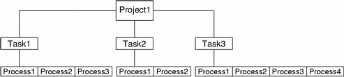

With each successful login into a project, a new task that contains the login process is created. The task is a process collective that represents a set of work over time. A task can also be viewed as a workload component.
Each process is a member of one task, and each task is associated with one project.
