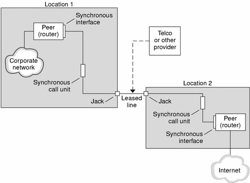

A hardwired, leased-line PPP configuration involves two peers that are connected by a link. This link consists of a switched or an unswitched digital service leased from a provider. Solaris PPP 4.0 works over any full-duplex, point-to-point leased-line medium. Typically, a company rents a hardwired link from a network provider to connect to an ISP or other remote site.
Both dial-up and leased-line links involve two peers that are connected by a communications medium. The next table summarizes the differences between the link types.

The leased-line link contains the following parts:
Two peers, each peer at one end of the link. Each peer might be a workstation or server. Often the peer functions as a router between its network or the Internet, and the opposite peer.
Synchronous interface on each peer. Some machines that run Solaris software require you to purchase a synchronous interface card, such as HSI/S, to connect to a leased line. Other machines, such as UltraSPARCTM workstations, have built-in synchronous interfaces.
CSU/DSU synchronous digital unit on each peer, which connects the synchronous port to the leased line.
A CSU might be built-in to the DSU, or owned by you, or leased from a provider, depending on your locale. The DSU gives the Solaris machine a standard synchronous serial interface. With Frame Relay, the Frame Relay Access Device (FRAD) performs the serial interface adaptation.
Leased line, providing switched or unswitched digital services. Some examples are SONET/SDH, Frame Relay PVC, and T1.
SONET is called an octet synchronous link. PPP uses a framing mechanism that is similar to asynchronous framing over a SONET line. PPP does not use the expected bit-synchronous protocol.
On most types of leased lines, peers do not actually dial each other. Rather, a company purchases a leased-line service to explicitly connect between two fixed locations. Sometimes the two peers at either end of the leased line are at different physical locations of the same company. Another scenario is a company that sets up a router on a leased line that is connected to an ISP.
