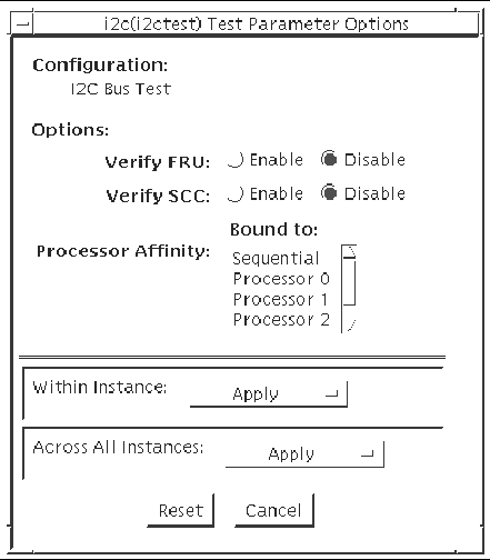

To reach the dialog box below, right-click on the test name in the System Map and select Test Parameter Options. If you do not see this test in the System Map, you might need to expand the collapsed groups, or your system may not include the device appropriate to this test. Refer to the SunVTS User's Guide for more details.
FIGURE 12-1 i2c2test Test Parameter Options Dialog Box
TABLE 12-1 i2c2test Options
i2c2test Options
Description
Verify FRU
Verifies the status of the FRU. Default is Disable.
Verify SCC
Verifies the status of the SCC. Default is Disable.
Processor Affinity
Specifies the processors to be tested in sequential order.
