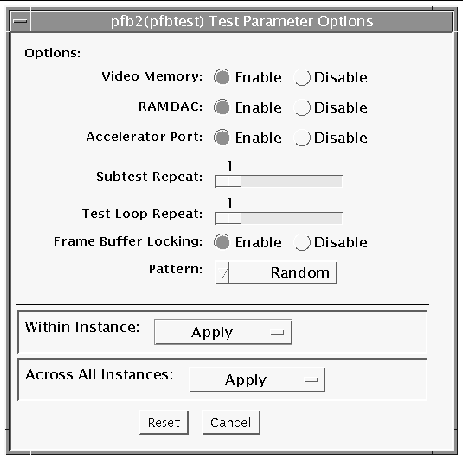

pfbtest Options
To reach the dialog box below, right-click on the test name in the System Map and select Test Parameter Options. If you do not see this test in the System Map, you might need to expand the collapsed groups, or your system may not include the device appropriate to this test. Refer to the SunVTS User's Guide for more details.
By default, all options are enabled except frame buffer locking.
FIGURE 5-1 pfbtest Test Parameter Options Dialog Box
TABLE 5-1 pfbtest Options
pfbtest Options
Description
Video Memory test
Thoroughly tests the on-screen video memory (the memory part that is mapped on to the monitor) of the Sun XVR-100 graphics accelerator in 8-bit, 16-bit, 32-bit, 64-bit, and 64 byte (block) modes. Entire on-screen video memory is tested by testing 512 bit blocks at a time (8x8 pixel block). Each block is tested in two passes. Each pass consists of a data write and read. In the first pass, user specified data or random data is used, and in the second pass, one's complement of the data used in the first pass is used so that each on-screen video memory location (bit) is tested with a zero (electrical low state) and one (electrical high state).
RAMDAC test
Tests the RAMDAC in three phases. In the first phase the RAMDAC CLUT (Color LookUp Table) is tested using simple write/read patterns to determine if there are any bad bits in CLUT.
The data patterns used are:
In the second phase, four different patterns are drawn on the screen. Each pattern stays on the screen for approximately 1/4 second. The four patterns are listed below. For each pattern, the signature is captured and compared with the signature obtained for the same pattern on a known good board. This test verifies that all the different data paths within the RAMDAC are functioning properly.
Patterns drawn on screen:
Red ramp with cursor at top-left corner of the screen
Blue ramp with cursor at top-right corner of the screen
Green ramp with cursor at bottom-left of the screen
Grey ramp with cursor at bottom-right of the screen
In the last (third) phase of the RAMDAC test the Vertical Retrace Interrupt is tested for approximately five seconds.
Accelerator Port test
Tests all of the following:
Data paths (sources: fixed color, host data, blit, fixed pattern)
Arithmetic and logic unit (ALU)
Primitives (destinations: line, rectangle)
Mono to color expansion logic
Primitives are drawn using a combination of different data paths (allowed), ALU functions, and color comparator functions. A checksum is generated for each data combination and is compared with the checksum generated for the same data combination on a known good board.
Frame Buffer Locking
This option is set to disable if the Sun XVR-100 graphics accelerator is not the console device.
When the SunVTS GUI is brought up, Frame Buffer Locking is enabled by default if the Sun XVR-100 graphics accelerator is the console device. If the Sun XVR-100 graphics accelerator is not the console device, Frame Buffer Locking is disabled by default.
