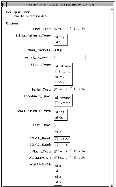

FIGURE 16-1 alarm2test Test Parameter Options Dialog Box With the Scroll Bar at the Top

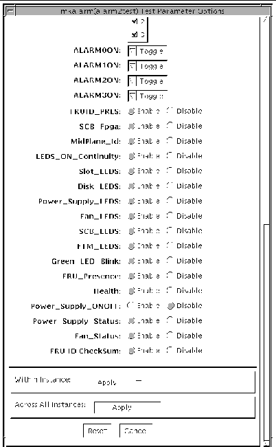

FIGURE 16-2 alarm2test Test Parameter Options Dialog Box With the Scroll Bar at the Bottom
TABLE 16-1 alarm2test Options
Option
Description
Enet_Test
Enables or disables Ethernet testing.
Edata_Pattern_Type
Selects the type of data pattern for Enet_Test: Sequential, Random, or both.
Num_Packets
Specifies the number of data packets to be sent in one test loop.
Target_IP_Addr
Specifies the IP address of a host to use for the ping test.
Etest_Type
Selects any or all internal, external, Phy (ethernet transceiver), or ping tests.
Serial_Test
Enables or disables serial_test.
Loopback_Type
Selects internal loopback, external loopback, or both.
Data_Pattern_Type
Selects the type of data pattern for serial_test: Sequential, Random, or both.
STest_Type
Selects ports to be tested: c, d, u, or v.
COM1_Baud
Selects the alarm card's COM1 port baud rate.
COM2_Baud
Selects the alarm card's COM2 port baud rate.
Flash_Test
Enables or disables the flash checksum test.
ALARMPORT
Enables or disables the alarmport test.
ALARMNUM
Selects any or all alarm ports to be tested: 0, 1, 2, 3.
ALARM0ON
Turns on, turns off, or toggles (on then off) alarm port 0.
ALARM1ON
Turns on, turns off, or toggles (on then off) alarm port 1.
ALARM2ON
Turns on, turns off, or toggles (on then off) alarm port 2.
ALARM3ON
Turns on, turns off, or toggles (on then off) alarm port 3.
FRUID_PRES
Enable/Disable FRU ID Presence test
SCB_Fpga
Enable/Disable scb_fpga register test
MidPlane_Id
Enable/Disable Midplane ID test
LEDS_ON_Continuity
Enable/Disable SCB LEDs test
Slot_LEDS
Enable/Disable Slot LEDs test
Disk_LEDS
Enable/Disable Disk LEDs test
Power_Supply_LEDS
Enable/Disable Power Supply LEDs test
Fan_LEDS
Enable/Disable Fan LED test
SCB_LEDS
Enable/Disable SCB Resgister LEDs test
FTM_LEDS
Enable/Disable Front Tranission Module LEDs test
Green_LED_Blink
Enable/Disable Green LED Blink test
FRU_Presence
Enable/Disable FRU Presence test
Health
Enable/Disable Health test
Power_Supply_ONOFF
Enable/Disable Power Supply On/Off test
Power_Supply_Status
Enable/Disable Power Suppluy Status test
Fan_Status
Enable/Disable Fan Status test
FRU ID CheckSum
Enable/Disable FRU ID Checksum test for Midplane, SCB, Alarm, Fan1/Fan2, and Power Supply1/Supply2
