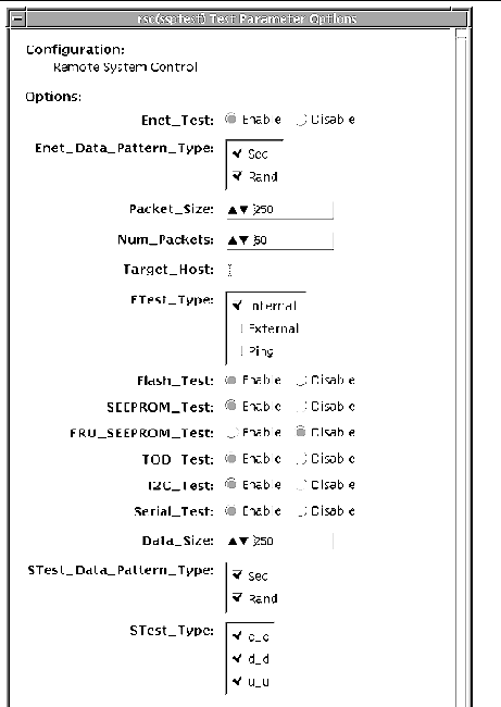

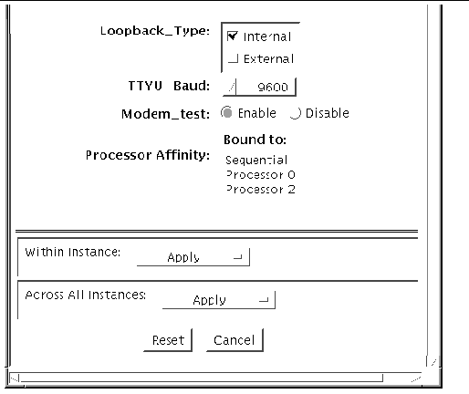

To reach the dialog box below, right-click on the test name in the System Map and select Test Parameter Options. If you do not see this test in the System Map, you might need to expand the collapsed groups, or your system may not include the device appropriate to this test. Refer to the SunVTS User's Guide for more details.
FIGURE 7-1 ssptest Test Parameter Options Dialog Box (Top Section)
FIGURE 7-2 ssptest Test Parameter Options Dialog Box (Bottom Section)
Note - The Configuration field in the ssptest Test Parameter Options dialog box displays the which type of hardware (RSC or ALOM) is being tested. For RSC 1.0 and 2.0, Remote System Control is displayed. For ALOM, Advanced Lights-Out Management is displayed.
TABLE 7-4 ssptest Options
ssptest Options
Description
Enet test
Enables or disables RSC or ALOM Ethernet testing.
Data Pattern Type
Selects Sequential, Random, or both types of data patterns.
Packet Size
Defines the size of each data packet to be sent for all tests.
Num Packets
Specifies the number of data packets to send in one test loop.
Target Host
Specifies the IP address of a host to use for the ping test.
Enet Test Type
Selects any or all Internal, External, or ping tests.
Flash test
Enables or disables the flash checksum test.
SEEPROM test
Enables or disables the SEEPROM checksum test.
FRU SEEPROM test
Enables or disables the FRU SEEPROM checksum test. (RSC 2.0 and ALOM only).
TOD test
Enables or disables the Time Of Day test.
I2C test
Enables or disables the I2C test (RSC 2.0 and ALOM only).
Serial test
Enables or disables the RSC or ALOM serial test.
Data Size
Defines the data size to be sent.
Loopback Type
Selects Internal, External, or both. External requires a loopback plug.
Data Pattern Type
Serial Test Type
Selects serial ports to be tested, u to u, c to c, or d to d.
TTYU_Baud
Select a fixed baud rate or all baud rates for testing the ttyu port. The valid baud rates under TTYU_Baud are: ALL, 300, 600, 1200, 2400, 4800, 9600, 14400, 19200, 38400, 57600, 76800, 115200. The default is 9600.
Modem Test
Used to Enable or Disable the RSC PCMCIA modem test (RSC 2.0 only).
