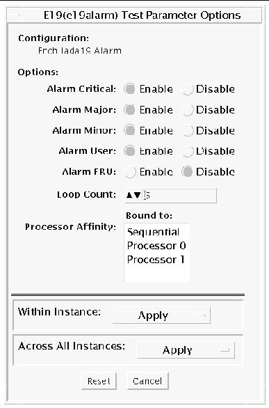

To reach the dialog box below, right-click on the test name in the System Map and select Test Parameter Options. If you do not see this test in the System Map, you might need to expand the collapsed groups. Refer to the SunVTS User's Guide for more details.
FIGURE 22-1 nalmtest Test Parameter Options Dialog Box
The following table describes the nalmtest options:
TABLE 22-1 nalmtest Options
nalmtest Options
Description
Alarm Critical
Toggles the Alarm critical LED.
Alarm Major
Toggle the Alarm critical Major.
Alarm Minor
Toggles the Alarm critical Minor.
Alarm User
Toggles the Alarm critical User.
Alarm FRUID
Performs the FruID checksum test on the alarm card.
Loop Count
Sets up the loop count for toggling all four alarm LEDS. The count number is 1 to 3.
