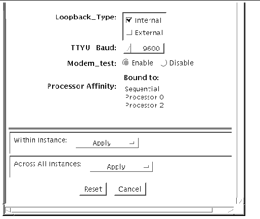

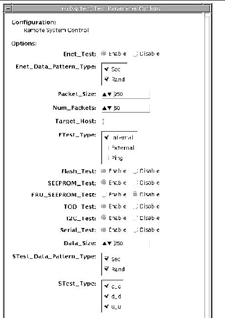

To reach the dialog box below, right-click on the test name in the System Map and select Test Parameter Options. If you do not see this test in the System Map, you might need to expand the collapsed groups, or your system may not include the device appropriate to this test. Refer to the SunVTS User's Guide for more details.
FIGURE 28-1 ssptest Test Parameter Options Dialog Box (Top Section)
FIGURE 28-2 ssptest Test Parameter Options Dialog Box (Bottom Section)
Note - The Configuration field in the ssptest Test Parameter Options dialog box displays the which type of hardware (RSC or ALOM) is being tested. For RSC 1.0 and 2.0, Remote System Control is displayed. For ALOM, Advanced Lights-Out Management is displayed.
