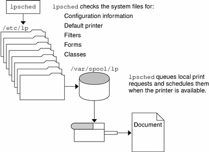

How LP Administers Files and Schedules Local Print Requests
The LP print service has a scheduler daemon called lpsched. The scheduler daemon updates the LP system files with information about printer setup and configuration.
The lpsched daemon schedules all local print requests on a print server, as shown in the following figure, whether users issue the requests from an application or from the command line. Also, the scheduler tracks the status of printers and filters on the print server. When a printer finishes a request, the scheduler schedules the next request, if one exists, in the queue on the print server.
Figure 8–1 The lpsched Daemon Schedules Local Print Requests
Illustration of lpsched checking default printer, filter, form, class, and configuration information before queuing and scheduling a print request.
Each print server must have only one LP scheduler running. The scheduler is started when a system is booted, or enters run level 2, by the /etc/rc2.d/S80lp control script. Without rebooting the systems, you can stop the scheduler with the /etc/init.d/lp stop command and restart the scheduler with the /etc/init.d/lp start command. The scheduler for each system manages requests issued to the system by the lp commands.

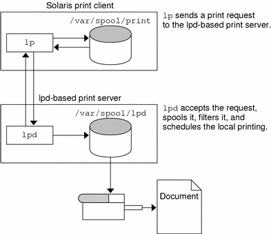

The following figure shows what happens when a user on a Solaris print client submits a print request to an lpd-based print server. The command opens a connection and handles it's own communications with the print server directly.
Figure 8–3 Printing Between a Solaris Print Client and a lpd-based Print Server
Illustration of a Solaris print client sending a print request to an lpd-based print server where it is accepted, spooled, and scheduled for printing.

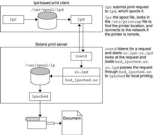

The following figure shows a lpd-based print client submitting a print request to a Solaris print server. The lpd daemon handles the local part of the print request and the connection to the print server. On the print server, the inetd process waits for network printing requests and starts a protocol adaptor to service the request. The protocol adaptor communicates with the lpsched daemon, which processes the request on the print server.
Figure 8–4 Printing Between a lpd-based Print Client and a Solaris Print Server
The preceding text describes the graphic.
