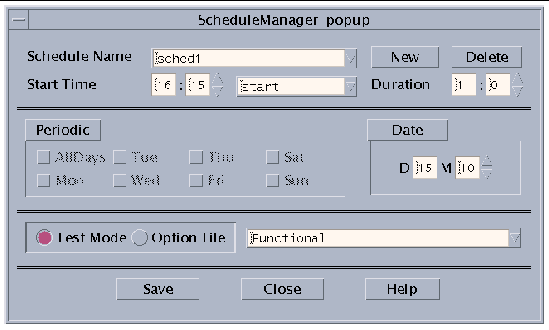

To reach the Schedule Manager dialog box below, select Scheduler
Schedule Manager
Create Schedule from the main SunVTS Diagnostic window. A list of the existing schedules and the standard options are displayed.
The following table describes the options listed in the Schedule Manager dialog box:
To bring up an existing schedule for viewing or editing, select a schedule in the Schedule Name drop-down menu, or enter the name of a schedule in the field.
