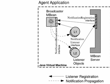

The JMX architecture defines a notification model that allows MBeans to broadcast notifications. Management applications and other objects register as listeners with the broadcaster MBean. In this way, MBeans may signal asynchronous events to any interested parties.
The JMX notification model enables a listener to register only once and still receive all different notifications that an MBean may broadcast. A listener object may also register with any number of broadcasters, but it must then sort all notifications it receives according to their source.
In the simplest case, listeners are objects in the same application as the broadcaster MBean. The listener is registered by calling the addNotificationListener method on the MBean. The MBean server exposes the same method so that listeners may also be added to an MBean identified by its symbolic name.
In the figure above, one listener has registered directly with the MBean and another has registered through the MBean server. The end result is the same, and both listeners will receive the same notifications directly from the broadcaster MBean.

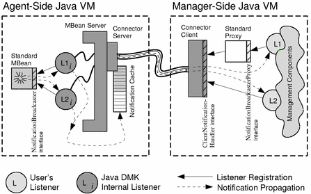

The connector client interface also exposes the addNotificationListener method so that notifications may be received in a remote management applications. Standard proxies also expose this method and transmit any listener registrations through the connector client.
Listeners do not need to be aware of the fact that they are remote. The connector transmits registration requests and forwards notifications back to the listeners. The whole process is transparent to the listener and to the management components.
As shown in the figure above, the connector components implement a complex mechanism for registering remote listeners and forwarding notifications. Since notifications are based on the Java event model, broadcasters cannot send notifications outside their Java VM. So the connector server instantiates local listeners who receive all notifications an place them in an cache buffer, waiting to be sent to the manager application. The buffer allows the connector to avoid saturating the communication layer in case of a burst of notifications.
Notifications can either be pushed from the agent to the connector client as they are received, or they can be pulled periodically at the client's request. The pushing mechanism is the simplest, but the pull mechanism can be used to group notifications and reduce bandwidth usage. In either case, the connector client then acts as a broadcaster and sends the notifications to their intended listeners.
The management application configures the forwarding mechanism through the connector client. The manager can choose either push or pull mode, and in pull mode, it can set the pull interval and the caching policy. The manager should set these parameters according to the notification emission rate, in order to avoid saturating the communication layer and yet receive notifications in a timely manner.

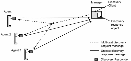

The discovery service enables you to discover Java Dynamic Management agents in a network. Only agents that have a discovery responder registered in their MBean server can be discovered using this service.
The discovery service can be functionally divided into two parts:
The discovery search service which actively finds other agents.
The discovery support service which listens for other agents to be activated.
In a discovery search operation, the discovery client sends a discovery request to a multicast group and waits for responses. The agents must have a DiscoveryResponder registered in their MBean server in order to be found by the discovery service. All discovery responder which receive the discovery request send a response containing information about the connectors and protocol adaptor which are available in their agent.
A manager application might use the discovery search service during its initialization phase, to determine all agents that are accessible in its network environment.
The discovery support service passively monitor discovery responders in a multicast group. When discovery responders are activated or deactivated, indicating that their agent is starting or stopping, they send a multicast message about their new state. A discovery monitor object listens for discovery responder objects starting or stopping in the multicast group.
By registering listeners with the discovery monitor, a management application may know when agents become available or unavailable. The discovery support message for an agent that is being started also contains the list of its connector and protocol adaptor.
A management application can use the discovery monitor to maintain a list of active agents and the protocols they support.

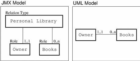

The relation service defines and maintains logical relations between registered MBeans. Users define the relation type and establish the relation instance which associates any number of MBeans. The relation service provides query mechanisms to retrieve MBeans that are related to one another.
In the JMX architecture, a relation type is defined by the class and cardinality of MBeans that it associates in named roles. For example, we can say that Books and Owner are roles. Books represents any number of owned books of a given MBean class, and Owner is a single book owner of another MBean class. We might define a relation type containing these two roles and call it Personal Library: it represents the concept of book ownership.
The following diagram represents this sample relation type, as compared to the UML modeling of its corresponding association.
Through the relation service, users may create relation types and then create, access, and delete instances of a relation. In our example, a management application may add Book MBeans to a Personal Library relation, or it may replace the MBean in the Owner role with another MBean of the same class. All MBeans are referenced by their object name, so that a relation may be accessed from a remote application.
The relation service is notified when MBeans in a relation are deregistered, and it verifies that any relation involving that MBean still has the required cardinality. For example, if an Owner MBean were deregistered, the relation service would remove any Personal Library relations where that MBean was the designated owner.
The relation service can represent a relation instance either internally or externally. If the user defines a relation instance through the API of the relation service, the relation is represented by internal structures that are not accessible to the user. This is the simplest way to define relations because the relation service handles all coherence issues through its internal structures.
A relation instance may also be a separate MBean object that fulfills certain requirements. The user instantiates and registers these MBeans, insures that they represent a coherent relationship, and places these MBeans under the control of the relation service. This process places the responsibility of maintaining coherency on the user, but external relations have certain advantages: they may implement operations on a relation instance.
For example a Personal Library relation could be implemented by an MBean with an operation called Loan. This operation would search the list of book MBeans for a title and implement some mechanism to mark that book as being on loan. And because external relations are MBeans, these extended operations are available to remote management applications.

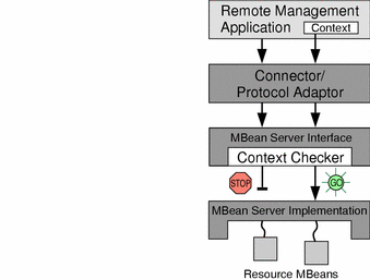

Whereas password-protection grants all-or-nothing access, context checking allows the agent application to filter each management request individually. Context-checking may be associated with password protection to provide multiple levels of security
All management requests that arrive through a connector or protocol adaptor may be inspected by the agent application to determine if they are allowed. The management application may filter requests based on the type of request, the MBean for which they are intended, or the values that are provided in the operation.
For example, context checking could allow an agent to implement a read-only policy which refuses attribute set operations, all operation invocation, and doesn't allow MBean registration or deregistration. A more selective filter could just insure that the agent cannot be disconnected: it would disallow MBean deregistrations, stop operations, and invocations that contain null parameters, but only when applied to connector servers or protocol adaptor MBeans.
In addition, requests through connector clients may be filtered by an operation context field, which could be a password or any other identifying data. The context object is provided by the management application, and it will be sent to the connector server along with each request. The agent can verify this context and potentially reject the request if the context is considered invalid or inappropriate for the operation.
To make this context checking possible, the agent provides:
Stackable MBean server objects - You can insert your own code to perform context checking and filtering between the communication component and the MBean server.
Thread contexts - Your code can retrieve the remote application's context object which is stored in the thread object which handles the request. The context is an arbitrary object that your code can use to determine whether or not to allow the request.
In the figure above, a context checker object has been inserted between the connector and the MBean server. Because a context checker object implements the MBeanServer interface, the connector interacts with it in exactly the same way as it did with the MBean server. This stacked object will retain a reference to the real MBean server, to which it will forward all requests that are allowed. The context checker may also perform any other action, such as log all filtered requests and trigger a notification when an invalid request is received.
For security reasons, only the agent application may insert or remove stackable MBean server objects. This operation is not exposed to management applications, who cannot even know if requests are being filtered. However, the context checker may choose to respond with an exception whose message explains why a request was denied.
