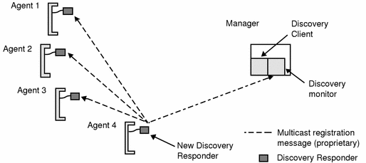

In passive discovery, the entity seeking knowledge about agents listens for their discovery responders being activated or deactivated. When discovery responders are started or stopped, they send out a proprietary message that contains all discovery response information. The DiscoveryMonitor object waits to receive any of these messages from the multicast group.
A discovery monitor is often associated with a discovery client. By relying on the information from both, you can keep an up-to-date list of all agents in a given multicast group.

The agents that wish to be discovered must have an active DiscoveryResponder registered in their MBean server. The responder plays a role in both active and passive discovery:
When the start operation of a discovery responder is invoked, it sends out a multicast message indicating that it has been activated.
When the discovery responder is active, it automatically responds to discovery requests.
When the responder's MBean is unregistered or its stop operation is invoked, it sends out a multicast message to indicate that it will be deactivated.
Both types of messages are proprietary and their contents are not exposed to the user. These messages contain information about the MBean server, its delegate's information and a list of communicator MBeans, unless not requested by the discovery client.
