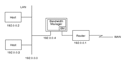

On a host that is between a LAN and a router, run Solaris Bandwidth Manager in IP-transparent mode.

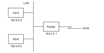

This mode is called IP-transparent because the host running Solaris Bandwidth Manager is completely transparent to the IP network and is perceived as just another machine connected to the LAN. The LAN and the WAN behave as though they are directly connected through the router only. It is not necessary to modify the routing tables.
The Kernel contains three modules which receive, filter, classify, schedule and forward the packets between the LAN and the router. The logical flow of data in IP-transparent mode is shown by the dashed lines in Figure 2-6.
