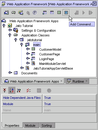

1. Select the main module folder, then click the Add Command button on the Web Application Framework toolbar.
The Select Command Type panel displays.

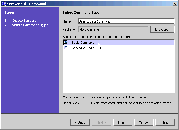

2. Enter UserAccessCommand in the Name textbox.
The UserAccessCommand component is added to the application.

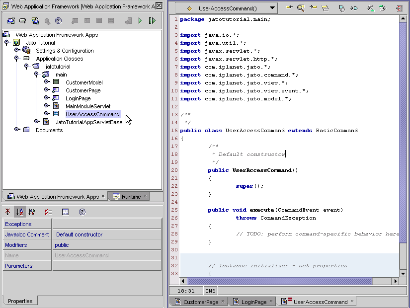

Double-click the UserAccessCommand to open the Java source code for this component in the editor window.
It is quite a simple class that extends BasicCommand. BasicCommand implements the Command interface which declares only one method:
public void execute(CommandEvent) throws CommmandException
This command currently does nothing. You will need to add some code to the execute method to do what you need it to do, which is, to perform a user login or logout based on the operation name that is passed in via the CommandEvent parameter. The operation names are completely up to the developer (you). The following steps and tasks instruct you on how to pass and evaluate your custom operation names.

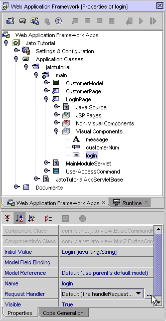

1. Expand the LoginPage node, and expand the Visual Components node.
2. Select the login button under Visual Components.

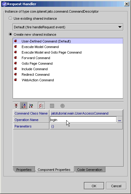

3. Click the ellipsis button for the Request Handler property.
This displays the Command Descriptor editor.

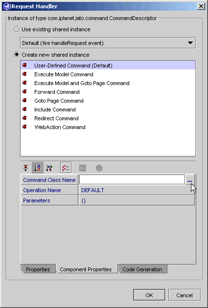

4. Select User-Defined Command (Default) from the list under the Create new shared instance radio button choice.

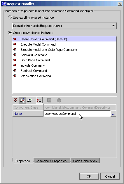

5. Change the Name property to userAccessCommand
6. Select the Component Properties tab at the bottom of the editor.

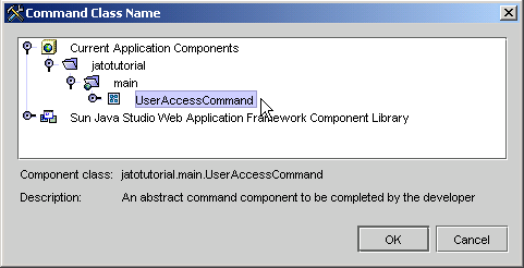

7. Click the ellipsis button for the Command Class Name property.
This displays the Command Class Name chooser dialog.
8. Expand the Current Application Components node, then jatoturial, and then main.
9. Select the UserAccessCommand command component.
11. Change the Operation Name from DEFAULT to login.
Recall in the code what you implemented for the execute method in the UserAccessCommand class. You have an if/else block that is expecting either login or logout as an operation name. These are case sensitive, so you need to be sure you set this correctly, or you will receive the CommandException (Unknown operation name) when you test run this command.
12. Click OK to finish setting the Command Descriptor property for the login button.
