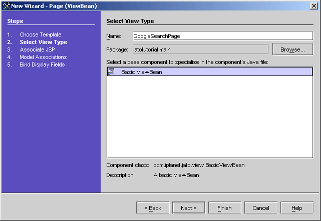

The Select View Type panel displays.
3. Enter GoogleSearchPage in the Name field (to replace <default>).

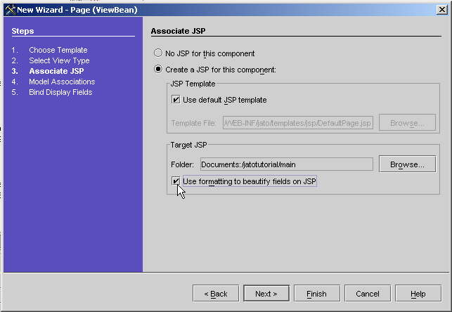

The Associate JSP panel displays.
6. Check the Use formatting to beautify fields on JSP option.

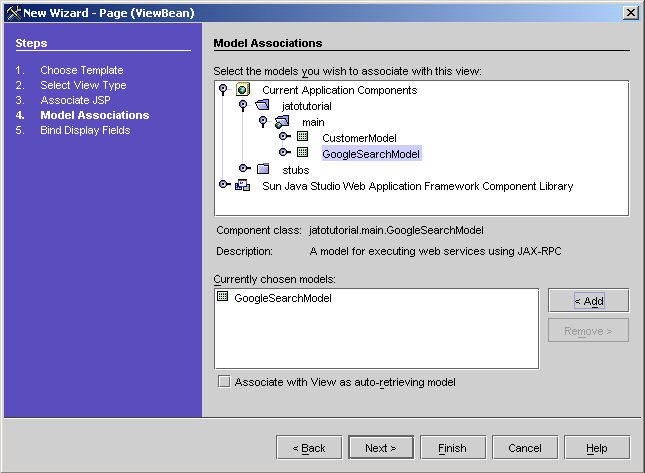

The Model Associations panel displays.
8. Expand Current Application Components to expose jatotutorial -> main.

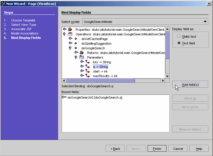

The Bind Display Fields panel displays.
12. Add the first field (as seen above):
a. Expand the doGoogleSearch operation node.
b. Expand the Parameters node.
c. Select the q field (q for query string: q -> String).
d. Select the Text field option.
The q field is added to the Bound fields list box.

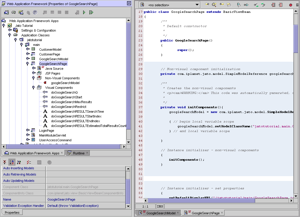

You have created the GoogleSearchViewBean.
16. The wizard automatically sets the Auto Retrieving Models property with the model that was used in the Page wizard. Normally, this is a desired setting, and therefore, the wizard assumes that it should be configured that way. However, with the Web service model, this is not the case.
a. Launch the Auto Retrieving Models custom editor by clicking its ellipsis button.
b. Select the googleSearchModel reference in the indexed list, and click the Delete button to remove it from the list.
c. Click the OK button to save the modifications.
17. Rename the fields to have shorter, simpler names (select the field and click F2 to rename).
The following table shows the longer field names in the left column, and the shorter names in the right column.
Set the properties for the start and max text fields according to the table shown below.
Note that you do not need to set properties for the restrict field.
Important: Launch the Initial Value editor by clicking the ellipsis button so you can select the Integer type. If you type the value in place in the property sheet, it is treated as a String.

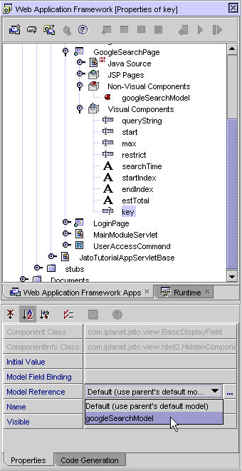

2. Add a Basic Hidden Field using the Component Palette.
4. Set the Model Reference property for the key field.
5. Select googleSearchModel from the drop down list.

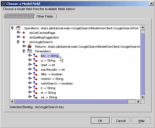

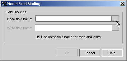

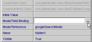

6. Set the Model Field Binding property.

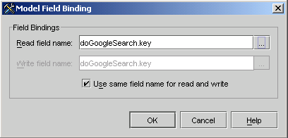

7. Click the ellipsis button to launch the Model Field Binding editor.
8. Click the ellipsis button for the Read field name property in this editor.
9. Expand the doGoogleSearch operation node, then expand the Parameters node.

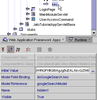

The read and write fields are populated with the doGoogleSearch.key model field.
12. Click OK to finish setting the Model Field Binding property for the key hidden display field.
13. Set the Initial value property (just above the Model field binding property) for the key field using the key that was emailed to you from Google.

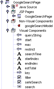

Your GoogleSearch Page node structure should look something the following figure:

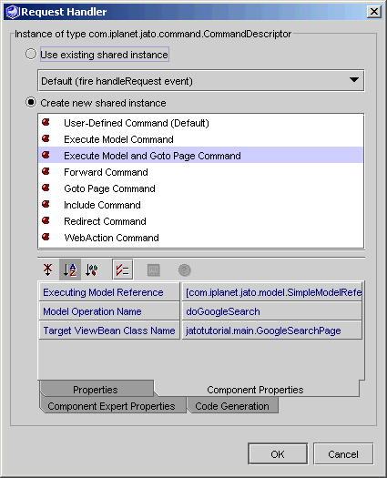

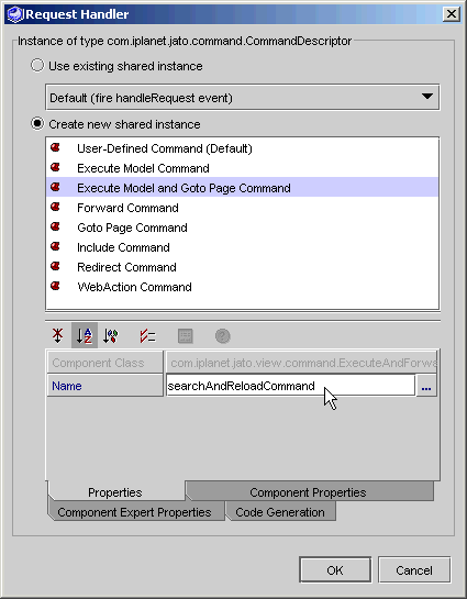

2. Launch the editor for its Request Handler property by clicking the ellipsis button.
3. Select the Execute Model and Goto Page Command option.
4. Set the Name to searchAndReloadCommand.
On the Component Properties tab, you need to set all three properties.

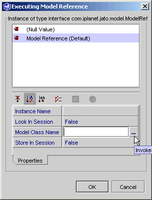

5. For the Executing Model Reference property, launch its editor by clicking the ellipsis button.
6. Select the Model Reference (Default) option.
7. Launch the Model Class Name property editor.
8. Browse and select the GoogleSearchModel.
9. When you return to the editor above, and the Model Class Name property is set properly, click OK.

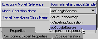

The Model Operation Name is a drop down control.
10. Select doGoogleSearch from its option list.
11. Launch the Target ViewBean Class Name editor.
12. Browse and choose the GoogleSearchPage.
Your Request Handler editor should now appear as shown in the figure below.
13. Click OK to finish setting the button's Request Handler property.
An addition to the GoogleSearchPage's Non-Visual Components node displays: searchAndReloadCommand.
