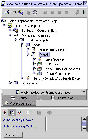

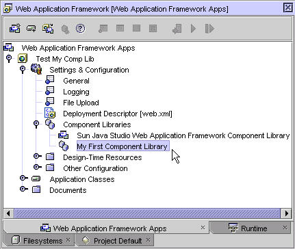

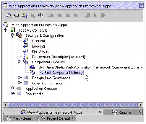

The library is fully recognized and functional when a new library node appears under the Web Application Framework application's Settings and Configuration -> Component Libraries node, as shown next:
This figure shows the newly created library node.

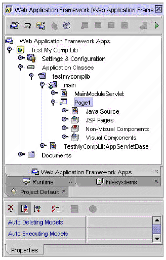

4. Create a new Page (ViewBean) object.
Take the wizard defaults, and the IDE names it "Page1".
5. Select and expand the newly created Page1 node.
This figure shows the expanded Page1 node and its property sheet.

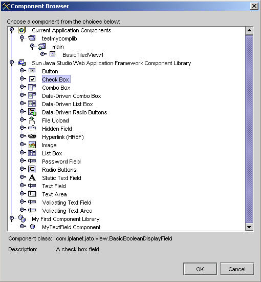

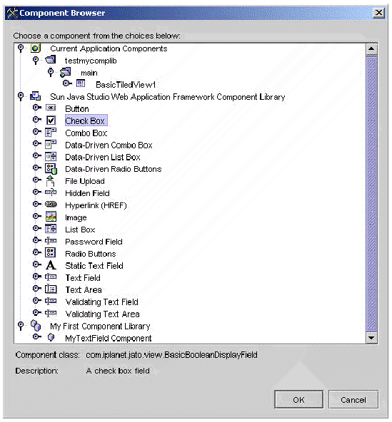

This figure shows the Component Palette with the contents of the Visual Components tab.

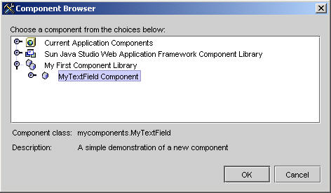

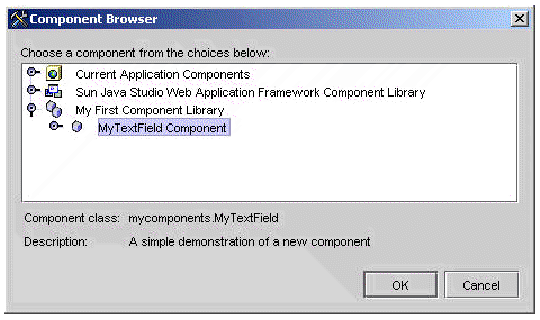

The Component Browser (shown next) is an alternative to the Component Palette (shown in the previous figure). In the rest of this document, any instruction that involves adding a visual component can be fulfilled by using either the Component Palette or the Component Browser. They are functionally interchangeable, and users can use either, or both, at all times.
This figure shows the Component Browser.
After selecting the MyTextField Component from either the Component Palette or the Component Browser, observe how a child View named "myTextField1" is added to the page.

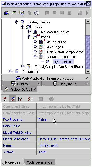

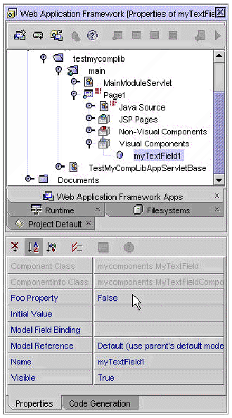

7. Select the child node myTextField1.
Observe how the IDE's property sheet has added Foo Property, the new custom property, in addition to the inherited TextField component properties.
This figure shows the child node, myTextField1.
Test the behavior of the Foo Property to make sure it behaves the way you, as component author, expect it should.
You should be able to assign the Foo Property the value True or False.
8. In this example, set the Foo Property to True.

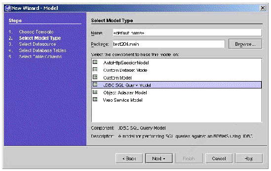

Extensible and Non-Extensible Components in the IDE
If you still find it confusing to distinguish extensible and non-extensible components, it might help at this point to refer to the IDE to see how the IDE toolset transparently exposes extensible and non-extensible components.

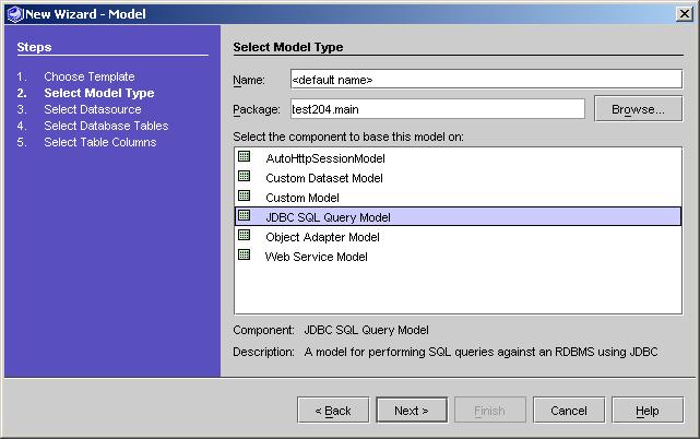

1. Open a Web Application Framework project and select a "module" folder.

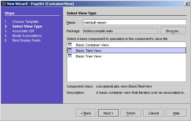

2. Right-click, and choose Add->Model or Add->Page (ViewBean) or Add->Pagelet (ContainerView).
These actions invoke wizards which contain an embedded extensible component browser, as shown next:
This figure shows the Extensible Component Browser of the New Pagelet (ContainerView) Wizard.
3. Complete either of the wizards, and the IDE toolset creates a new class that extends the extensible component's class.
This figure shows the Extensible Component Browser of the New Model Wizard.
4. Select an existing page or pagelet node.
Expand the top node so you can see its inner Visual Components node.
5. Select the Visual Components sub-node, right-click, and select the Add Visual Component action.
This invokes the non-extensible component browser (shown next).
6. Complete the selection of a child view.
This does not result in the creation of a new class, but rather adds a child element to the currently selected class.
This figure shows the Non-Extensible Component Browser.
The figure above shows the Non-Extensible component browser employed in the context of "Add Visual Component" action. This figure shows the browser fully expanded to show two libraries and the current application's non-extensible components.

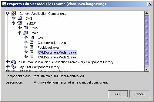

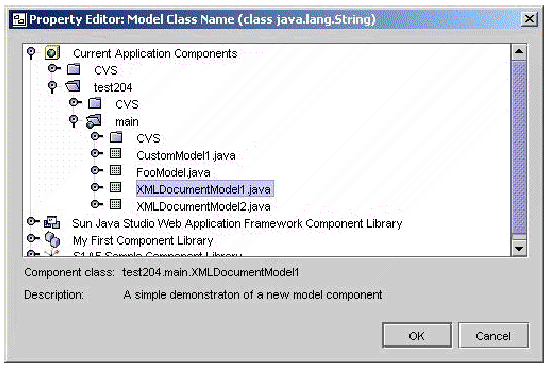

In other areas of the IDE, the non-extensible component browser is used to select Page/Pagelets, or Models, or Commands for assignment to certain property values. For instance, wherever a Web Application Framework use relationship is expressed in a property (for example, a View uses a Model), the property editor can leverage the non-extensible component browser to enable the application developer to select a valid target object.
For instance, properties of type Model Class Name are edited using a non-extensible Component Browser which shows non-extensible Model components in the mounted component libraries (if any), and also any Models which have been added to the current application. Similar behavior applies to editing the "Command Class Name" property. However, in that case, Command components are selected instead of Models.
This figure shows the Model Class Name Browser (property editor).
The figure above shows the Non-Extensible component browser employed in context of a Model Class Name property editor. This figure shows the browser fully expanded to show two libraries and the current application's non-extensible Model components.
