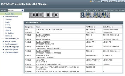

The Chassis Inventory table lists the blades and NEMs installed in the system.
Note - To locate the positions of the blade and NEM slots in the chassis, see the diagram of blade and NEM slots in Chassis Blade and NEM Slots.
