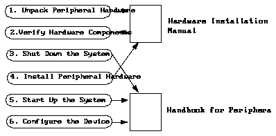

Task Map for Getting Your System Running
The diagram below outlines the tasks you can perform to successfully install a new peripheral. Each numbered item in the diagram represents a procedure and the arrows point to manuals in which these procedures are detailed.
After you perform these tasks, you will be ready to use the new board with your system.
