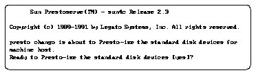

When presto_chango is run with no arguments it determines an expected mode of operation (by looking for a file which presto_chango would have installed) and asks you to verify the choice:
The sd and id devices are the standard sun4c and sun4m disk devices. If you want another disk driver type accelerated, use the "-p prefix" flag when running presto_chango to specify the prefix . Note that to accelerate ("Presto-ize") a device, the only entries that are required are in the sys/sun/conf.c file. You do not need the physical device installed nor does the device have to be one which you would normally configure in a kernel. Press RETURN now to continue the install operation, or type "n" to switch the mode of operation. In this case, presto_chango switches the mode of operation and asks:
Do you wish to remove Presto from host instead [no]?
If you answer "y", presto_chango returns to the previous sentence and prompts you to verify the new mode of operation. Otherwise, you can type "n" or press the RETURN key to cause presto_chango to exit.
