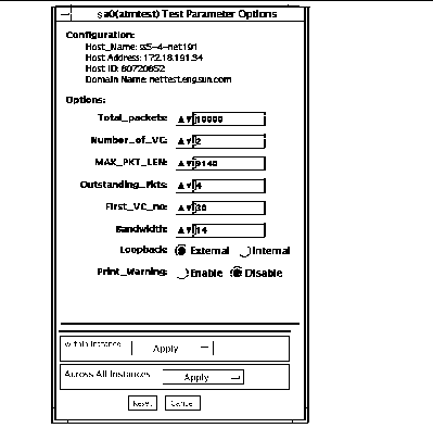

To reach the dialog box below, right-click on the test name in the System Map and select Test Parameter Options. If you do not see this test in the System Map, you might need to expand the collapsed groups, or your system may not include the device appropriate to this test. Refer to the SunVTS User's Guide for more details.
Figure 4-1 atmtest Test Parameter Options Dialog Box
Graphic
Table 4-1 atmtest Options
Options
Description
Configuration
The post address, host ID, and domain name of the system being tested.
Total packets
The total number of packets sent. The default number of packets sent is 10000.
Number of VC
The default number of virtual circuits is 2. The atmtest uses these two virtual circuits to send out messages simultaneously. The message is received in sending order.
MAX_PKG_LEN
The maximum packet length to be used by the test to send out the data. The default number is 9140.
Outstanding_pkts
Describes the maximum number of outstanding packets. atmtest stops sending messages when the outstanding packet count is more than the number of packets this field specifies.
First_VC_no
Enables the user to set up the starting virtual circuit number to be used for each atmtest instance. atmtest can automatically avoid virtual circuit numbers that have already been used.
Bandwidth
Enables the user to select different bandwidths to test. The default number is 14.
Loopback
Enables the user to select either the external loopback field or internal loopback field. The default selection is the external loopback field. A loopback connector is only needed for external loopback testing.
Print Warning
Disabled by default. Click enable to see warning errors, such as retry on timeout.
