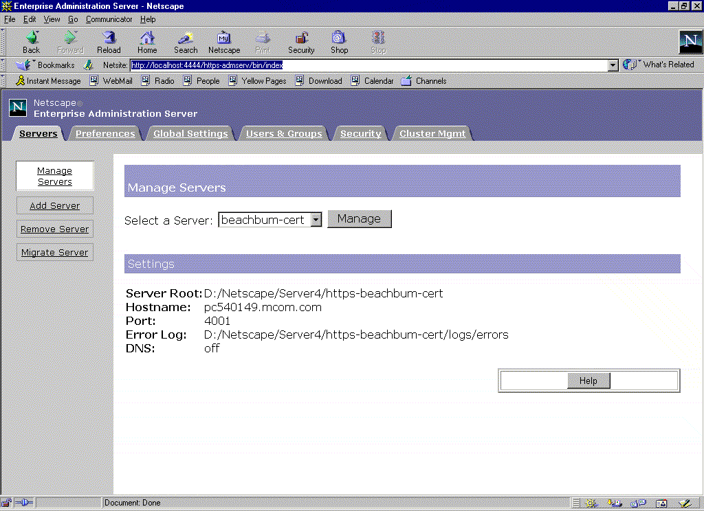

- Open up a Netscape Navigator window to the Administrative Server for the Web Server:
NOTE: For this example, it is assumed that an Web Server
has been installed, enabled, and is up and running. Please supply the
name of your admin server for <server_name>
and the
port of your admin server for <server_port>
For this example, a server named "gandalf" is used.

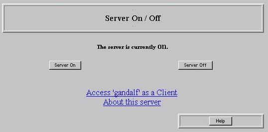

- On this screen, click the button with your server name ("gandalf"
in this case), and the Server On / Off window should appear:

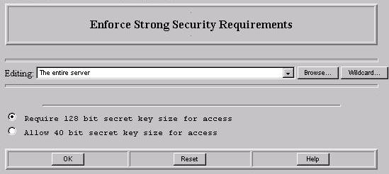

- From the Server Preferences menu, select Stronger Ciphers.
The Enforce Strong Security Requirements screen should appear:

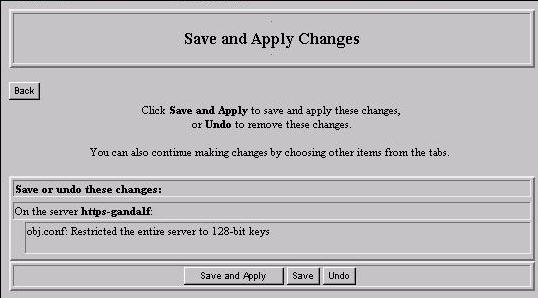

- Select Require 128 bit secret key size for access,
click OK, and the Save and Apply Changes screen should appear:

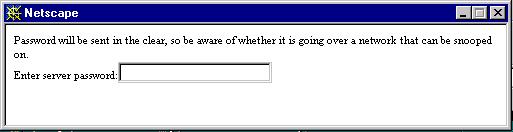

- Click Save and Apply, and a password dialog should appear:
- Enter the password, and press return. The changes are processed,
and if successful, the following alert box should appear:

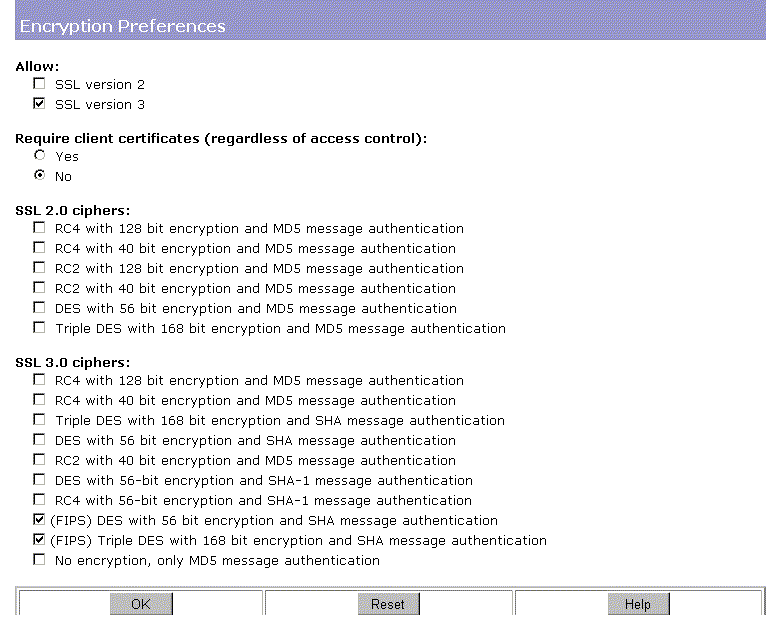

- From the Server Preferences menu, select Encryption Preferences,
and the Encryption Preferences screen should appear:
- Check and uncheck the options in this screen (as shown above) so that
the only option allowed is SSL version 3 and the only SSL 3.0 ciphers allowed
are Triple DES using SHA and DES using SHA. Click OK.

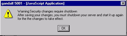

For these changes to be processed, the server must be shutdown and
restarted. The following popup alert should appear:

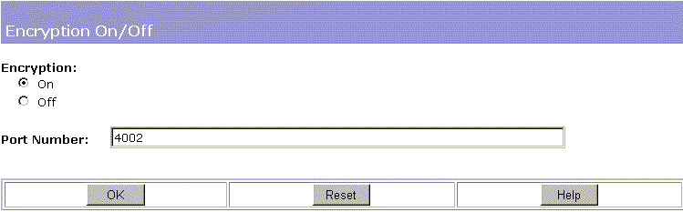

- From the Server Preferences menu, select Encryption On / Off.
The Encryption On / Off screen should appear:
- Select On, enter the
<server_port>
port number
(the port number in the example above is 5666), select an alias
(the alias in the example above is "web"), and click OK.
