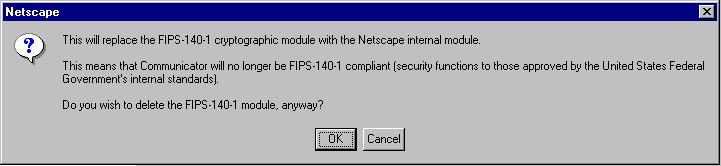

  6. Select the FIPS PUB 140-1 and click Delete. The following dialog box appears, prompting you to load the PKCS #11 Module:
  7. Click OK, and the following PKCS #11 Cryptographic Module should be loaded:

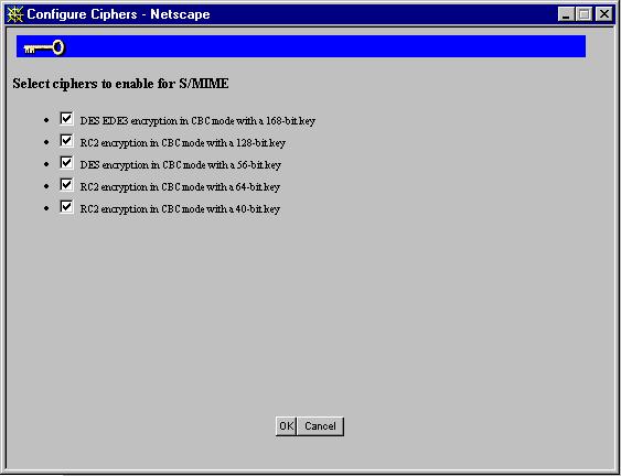

  9. Click Select S/MIME Ciphers. The Configure Ciphers dialog box should appear.
    Make sure that the following checkboxes are checked:
    • Triple DES encryption in CBC mode with a 168-bit key
    • RC2 encryption in CBC mode with a 128-bit key
    • DES encryption in CBC mode with a 56-bit key
    • RC2 encryption in CBC mode with a 64-bit key
    • RC2 encryption in CBC mode with a 40-bit key
    The dialog box should look exactly like this:
  10. Click OK and return to the Security Info window.

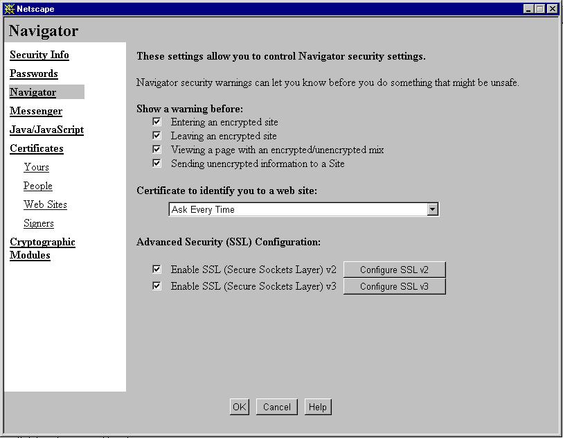

  11. In the left frame of the Security Info window, click Navigator. The Navigator section appears in the Security Info window.
    Make sure that the check box in front of the SSL v2 line is checked, so that the Navigator section looks like this:

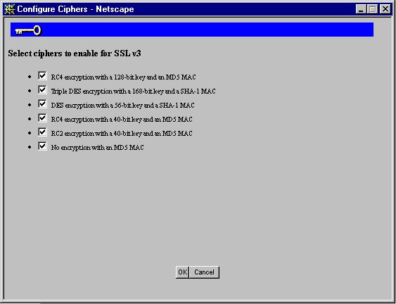

  12. Click Configure SSL v3, and the Configure Ciphers dialog box should appear.
    • RC4 encryption with a 128-bit key and an MD5 MAC
    • Triple DES encryption with a 168-bit key and a SHA-1 MAC
    • DES encryption with a 56-bit key and a SHA-1 MAC
    • RC4 encryption with a 40-bit key and an MD5 MAC
    • RC2 encryption with a 40-bit key and an MD5 MAC
    • No encryption with an MD5 MAC
  13. Click OK and return to the Security Info window.
