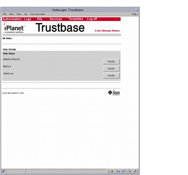

Defining a role
Selecting <Add role> from the main menu will provide a form that contains the following:
Submitting the form will update the authorisation tables immediately. After adding a new role, using the view role option from the authorisation menu will contain the updates immediately. The view roles option on the main menu allows the operator to select an existing role and modify the original values. By default the iPlanet Trustbase Transaction Manager has three pre-set roles that map to specific users.
- Name - The text label for the new role
- Description - Free text description of the role. This is not used by the authorisation mechanisms, but is useful for describing the use of a particular role
- Active - Unchecked means the router will throw an unauthorised response even if the role to service link is correct.
Figure 4-2 List of default Roles
- Administrator This role allows Administration access to all configuration screens.
- NoRole - This is a role that is not active and is currently for internal use only. It is a holder for assigning "items" no role.
- Identrus - This role allows access to Identrus Services. At present there is one main service IdentrusCSCService that performs certificate status checks and forms the basis of all Validation, verification, integrity and authentication.
Note The iPlanet Trustbase Transaction Manager contains a default Role 'NoRole'. This is used internally by the iPlanet Trustbase Transaction Manager Services and should not be modified of removed.

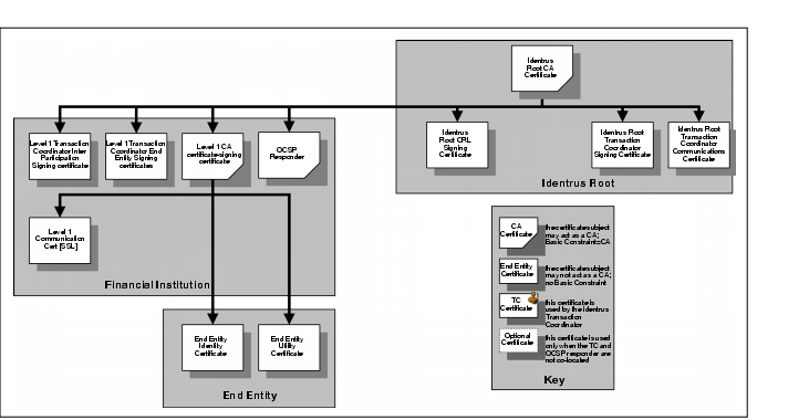

Certificate authentication is used for Identrus messages, and before a third party may interact with the iPlanet Trustbase Transaction Manager they must have the certificate details entered in the Authorisation system. iPlanet Trustbase Transaction Manager removes the need to enter every known certificate in the Authorisation table by allowing the use of parent certificates in lieu of the actual certificate.
Figure 4-4 Identrus PKI hierarchy
In the Identrus PKI hierarchy the End Entity Identity certificates issued by the Level 1 CA are used by the Relying Customer to sign requests to the iPlanet Trustbase Transaction Manager. The Level 1 Transaction Manager Inter-Participant Signing Certificate is used to sign requests made between the various iPlanet Trustbase Transaction Managers during a certificate status check.
The complete set of Identrus operations may be authorised by placing a single certificate in the authorisation system. This certificate is the Identrus Root CA Certificate. This Root CA certificate must be entered with a Maximum Depth value of 2. This indicates that certificates issued up to 2 levels below the Root CA certificate i.e. The Level 1 Transaction Manager End Entity Signing Certificate, and the Inter-Participant Signing Certificate(s) will be mapped onto the same Role as the Identrus Root CA certificate.

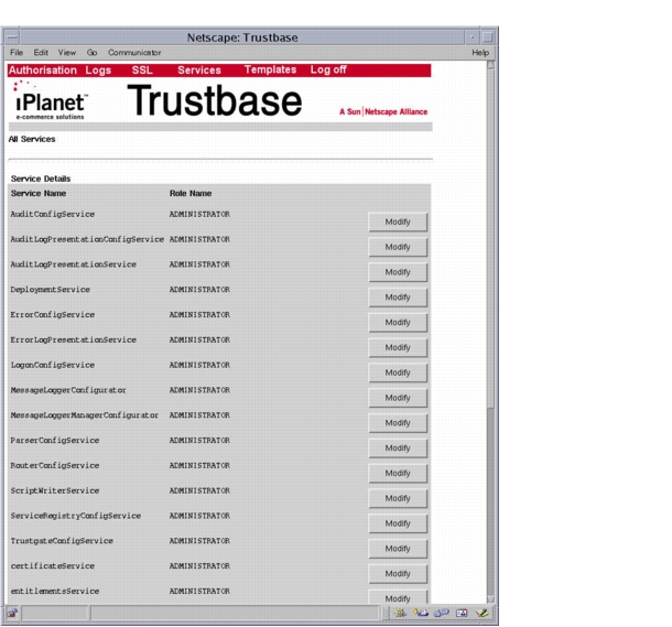

Mapping roles to Services
Having created a role and mapped a set of users to the role the final step is to define the set of services that may be accessed using the role.Each service is capable of being accessed by a single role. This requires some design and thought to the authorisation mappings prior to modifying an existing authorisation mechanism. By default the iPlanet Trustbase Transaction Manager contains an existing set of role to service mappings that allow the following:
To map a new service to a role select new service on the Authorisation main menu. The form requires the following information:
- Operators to configure the installation using the configuration facilities described in this guide. This maps onto the "Administrator" role name.
- Holders of End Entity Certificates to access the approved set of Identrus service subject to mapping the certificate details onto the "Identrus" role.
A number of service to role mappings may be added to the list at the bottom of the form prior to submitting the form. Once the mappings have been submitted to the authorisation database they are effective immediately.
- Service name - The short name of the service found in the tbase.properties file
- Role - The name of the role
To modify an existing service to role mapping, select the edit services from the Authorisation main menu. This presents a list of the entire role to service mapping database for inspection. Selecting the Modify link on a particular item in the list will allow the details of the specific entry to be updated.
Figure 4-6 Services to role mapping list
